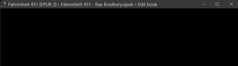

The book editor suddenly stopped working. when opening the editor I get a black window. Other parts - the 2 use: manager and viewer - behave as usual.
haven't opened the editor in a few weeks so I'm not sure when it exactly this happened.

OS: Windows 11.
The editor's window remains open until I close it manually. There is a taskabar icon and an on-hover preview (of a black window).
I tried multiple books - it's the same for all of them.

You might think that page's explanation is clear, but it's not for me. How do I use [--disable-gpu]? just trying the run the editor with ebook-edit.exe --webEngineArgs --disable-gpu doesn't work.
Also, after some clicking around the black windows, I realized all the elements are present: clicking on the general top-left area open the dropdown menu; I can copy html from the general area of the text editor, and so on... It's just that everything is black.

The latest update for AMD gpu v24.7.1 fixed the issue
