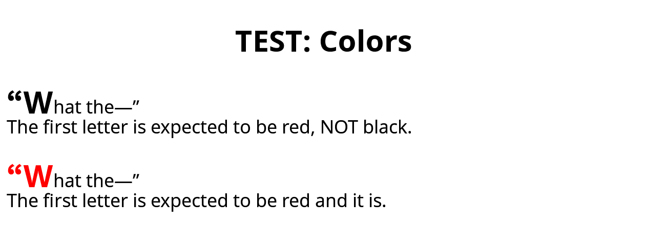

The first finding (see attachments) was that a colored "dropcap" did not showed.
The used original style found in the epub:
  span.dropcap1 {
    font-size: 1.75em;
    font-weight: bold;
    color: Red;
  .special {
    font-family: sans-serif;
The (abbreviated) used original text:
<p><span class="dropcap1"><span class="special">“W</span></span>hat the—”</p>
I got it to work with this change:
  span.dropcap2 {
    font-size: 1.75em;
    font-weight: bold;
    color: Red;
The used changed text:
<p><span class="dropcap2">“W</span>hat the—”</p>

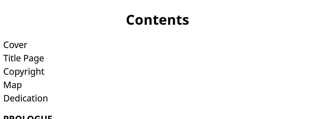

My second finding (see attachments) was that "links" (tag <a>) are not by default shown in "blue", which is odd.
Did anyone have similar findings?
PS: Kepub-yfing the epub by just adding ".kepub.epub" did made both text variants show in red, while "links" now are grey-ish with an underline even while the style setting did specified text-decoration: none;.

Yes, I've noticed this too. Some TOCs that are blue in epubs (both underlined or not) are black on the LC. This also happens with chapter titles and sub-titles.
With very little knowledge of css/html editing, I have been unsuccessful in correcting it.
Ok, I already figured it was not just me
I had little experience too in the past, when I found this forum and joined it. I experimented a lot and start loving google as my friend.
For the moment I did found a possible solution (=workaround):
a {
  color: blue;
It seems that CSS elements do not seem to have default (color) values within Kobo LC (for EPUB), so explicitly setting them works (for me at least) for the moment. I still consider the LC as a work in progress.

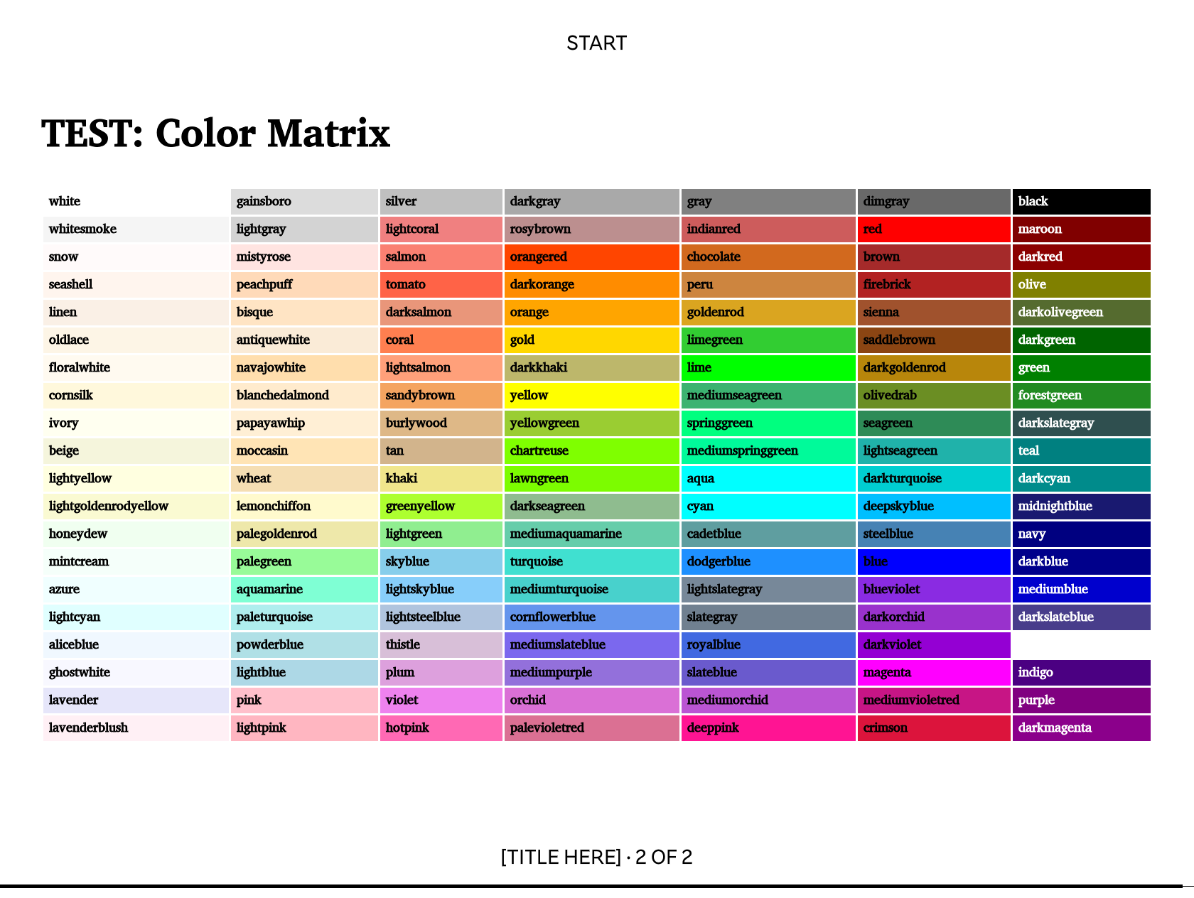

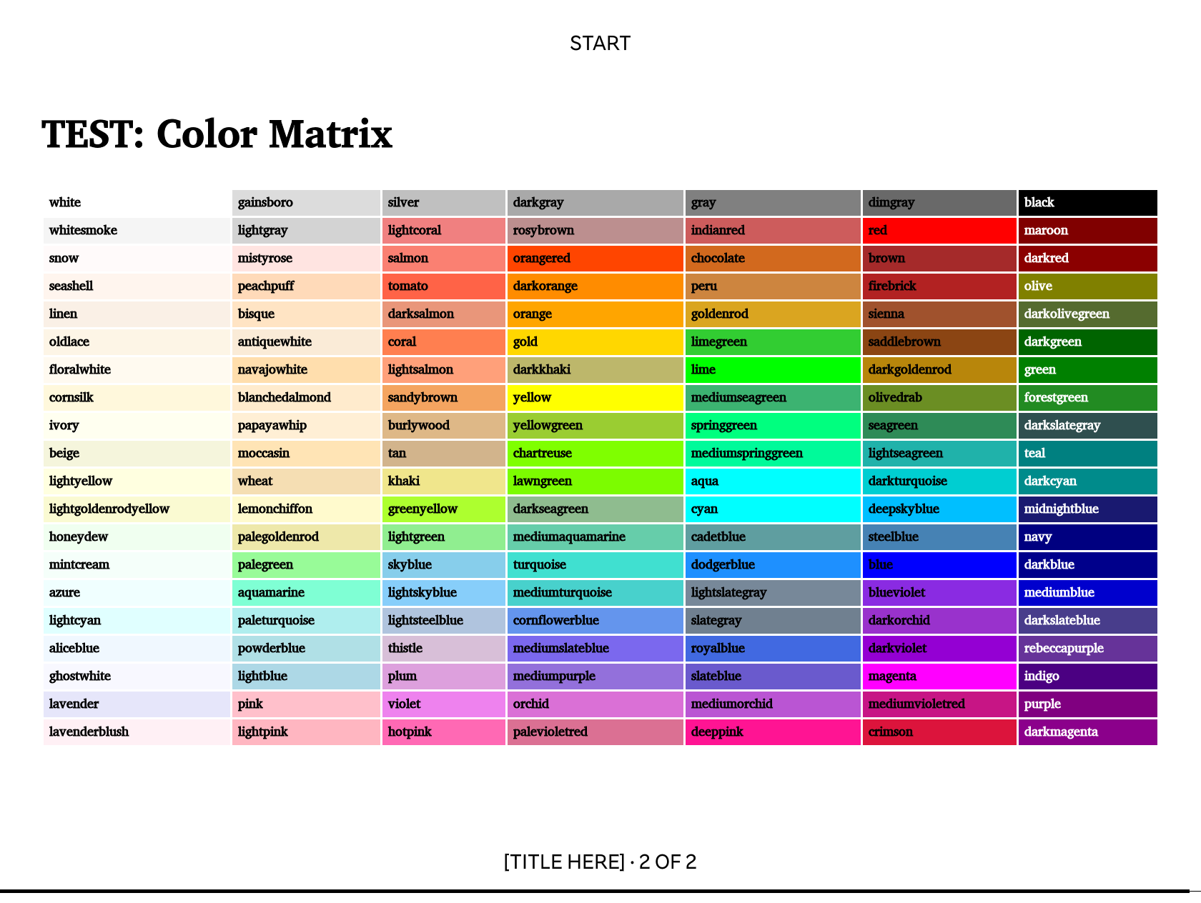

I did some color tests and found the following results (see attachment KLC screenshot).
Mark the missing color last column, 4th entry from bottom. That was supposed to be "rebeccapurple", but seems to be not displayable on the KLC, it is in the calibre viewer and other devices.

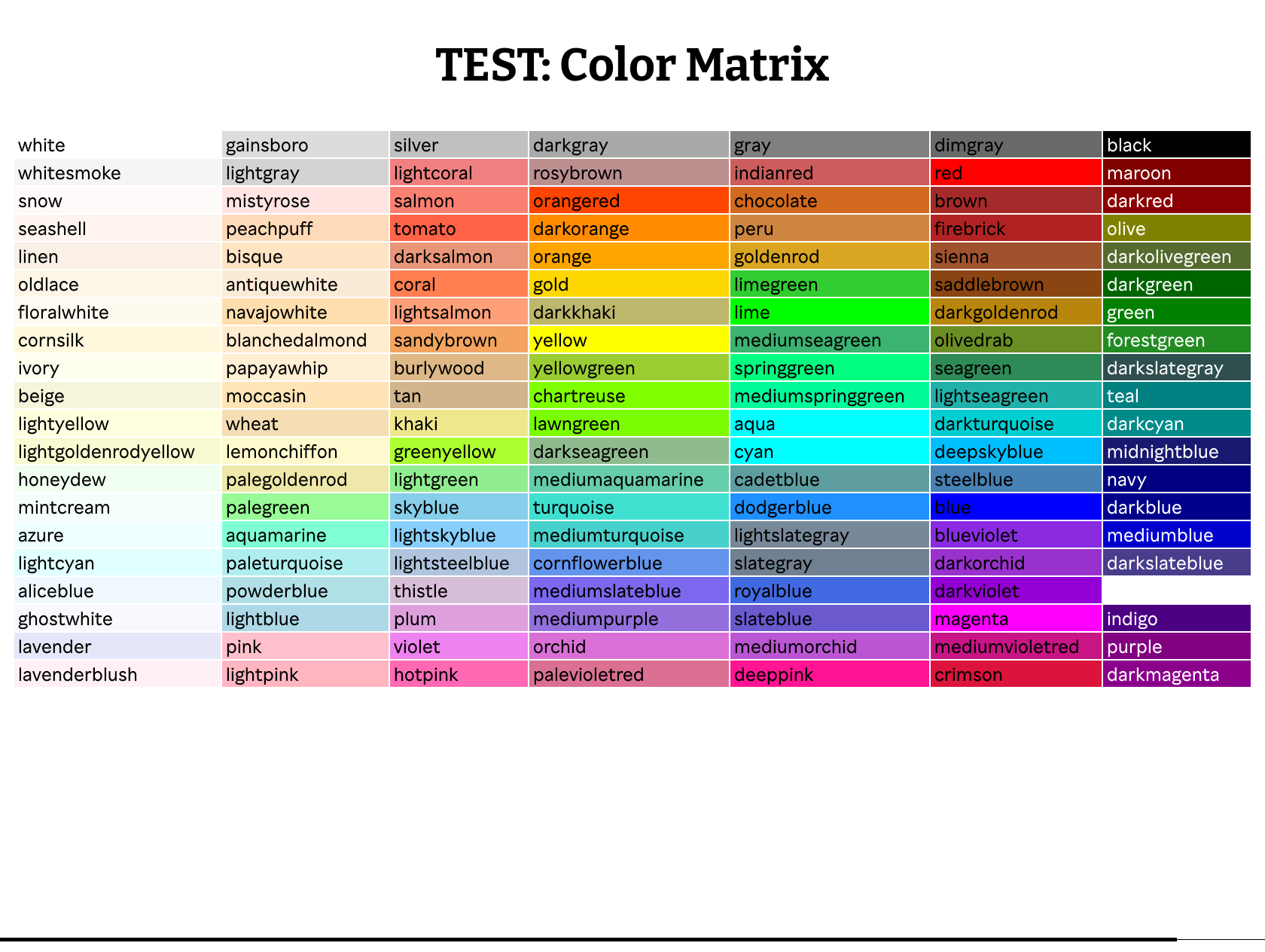

A screenshot though is misleading compared to a photo of the screen.
It's odd that a screenshot doesn't do "true colour", i.e. 24 bit RGB, 8 bits per R, G and B. Some mono Kobos certainly did when I checked years ago.
True, even same kind of devices can provide different results. Hmm, perhaps I better can provide the html code, so everybody interested can include it in an ebook and have a look on their own device.

        <td style="background-color:orange" title="orange = #ffa500">orange</td>
        <td style="background-color:goldenrod" title="goldenrod = #daa520">goldenrod</td>
        <td style="background-color:sienna" title="sienna = #a0522d">sienna</td>
        <td style="background-color:darkolivegreen;color:white;" title="darkolivegreen = #556b2f">darkolivegreen</td>

For what it may be worth, I see the same thing. Rebeccapurple does not work but #663399 does work. This has been reported to Kobo.
<td style="background-color:rebeccapurple;color:white;" title="rebeccapurple = #663399">
          rebeccapurple
        </td>
      </tr>
<td style="background-color:#663399;color:white;" title="rebeccapurple = #663399">
          rebeccapurple
        </td>
      </tr>
