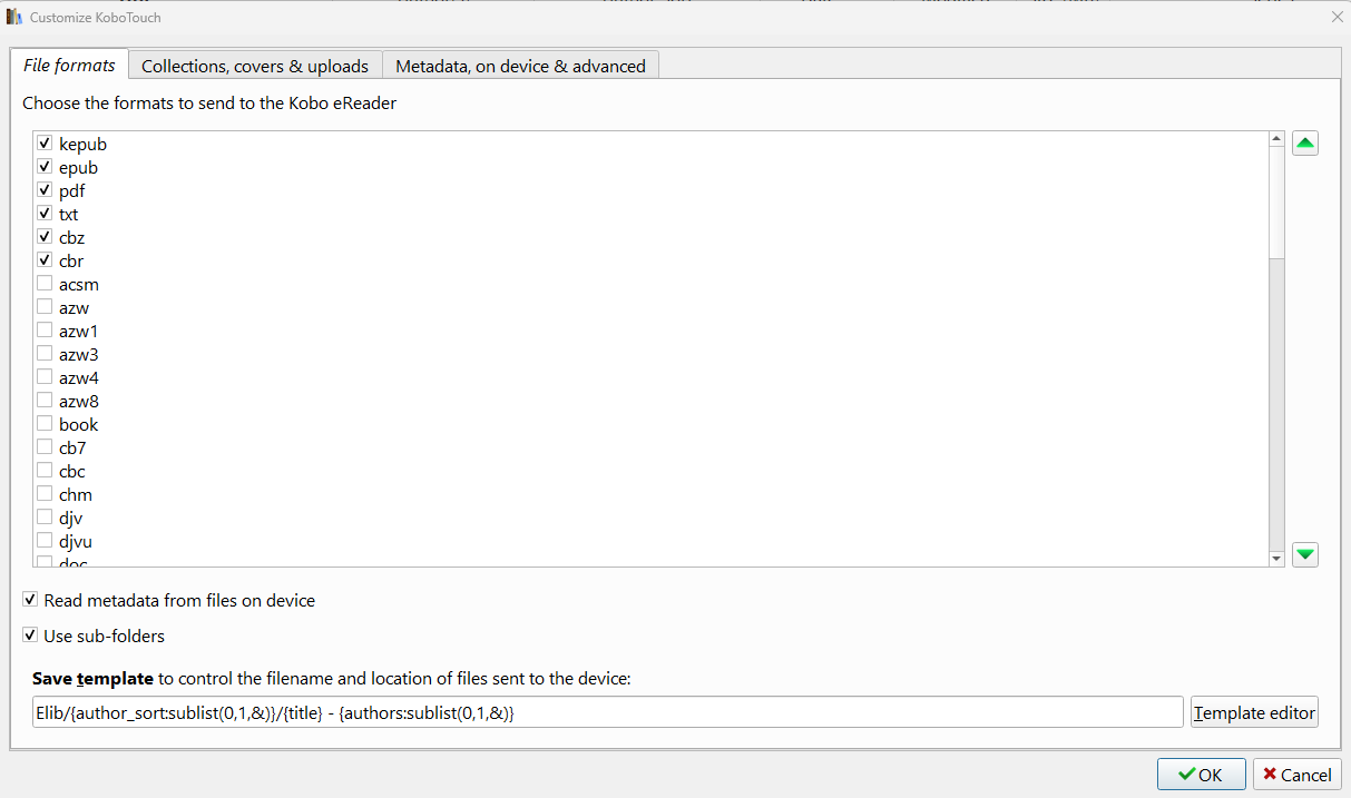

When you safely eject your Clara BW, does it go into the importing books screen? What directory are you sending your books to? If you open the configuration for the KoboTouch (or KoboTouchExtended) driver, what is the template at the bottom of the first page?
For example, mine is "Elib/{author_sort:sublist(0,1,&)}/{title} - {authors:sublist(0,1,&)}" which places any books sent in the Elib directory in the root of the exposed storage. Within that directory, books are sent to directories based on the first entry in the author sort list with the filenames based on the book title and the first entry in the author names. I.e. Mage Assassins & Other Misfits by Annette Marie & Rob Jacobsen would be saved as:
Elib/Marie, Annette/Mage Assassins & Other Misfits - Annette Marie.epub
Name:	Screenshot 2024-06-09 105217.png

Thank you DNSB for your reaction.
we have two Kobo Readers. I have a Kobo Clara HD an my wife a Kobo Clara BW. The problem is with the BW.
They have both the same formats to send to the Kobo reader -->
{author_sort}/{title} - {authors}
However you mentioned that this placed every book send in the root of the exposed storage.
When I connect the reader to my desktop I also can look in (G:\ KOBOeReader) the map what is on the reader.
Both readers shows in this map list (the books) a map called "Digital Editions" in that map is a new map mentioned "Annotations" and in that map are showed the books as Type ANNOT.
The transferred books I cannot find/see on my wife's Ereader are in the "books" map list, however not in the map called "Digital Editions" and in Annotations.
In my reader all books showed in the book map list are also in the Annotations map.
So I think that is the problem why they are not showed, however how can I solve this?
