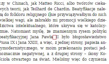

Hello.
I use hyphenate this on my ebooks but although it makes the words hyhen here and there it still does not make all spaces between words equally white as I expected it to do. You can see on the attached screenshot that although some words are hyphenated the space marked in red is much wider than the one marked in green (it's from Calibre preview but looks exactly the same on my Kindle). Is the way to set up the plugin to make spaces equally wide like in real paper books?

No. It has to follow it's rules for hyphenation. While you might be able to find a better hyphenation dictionary, if you want to have a fully justified experience such as most printed books offer, you need to use microjustification where the width of spaces between words and the character spacing within words are both modified for every line requiring justification.
This will make all spaces equally wide? Is it possible to do it in Calibre?

There is no way to make all spaces exactly the same. Not even in a printed book (pBook) can the spaces be makes the same.
You can make the spaces smaller if you use ChareInk6SP as your font.
https://www.mobileread.com/forums/sh...d.php?t=184056

No. That requires the renderer (the software that actually puts the text on the screen) to have that capability. Eink ereaders are low power devices which do not have the CPU power to microjustify without extreme slowness in displaying a page. Adobe's InDesign will do that for books that are intended for print or PDF and it chews up CPU cycles on an i9 like they were free.
Interesting topic. I also did wonder what causes some discrepancies regarding hyphenations in various readers and devices. In Kindle and in Pocketbooks default readers Hyphenations work in fairly the same way, they are rarely utilised, and often leave plenty of space in lines. Koreader on Pocketbook fares a lot better, though. It helps that it also has various font setting, like kerning and spacing, that allow higher degree of text tweaking.
I've Indesign in my package, but my knowledge of it is extremely limited. How would one go at converting reflowable book into fixed pdf with these microadjusted hyphenations in mind?

Microjustification tries to avoid hypenation as much as possible, there is no such thing as microadjusted hyphenations. By playing with the spacing between words and the spacing between characters in a word using a fixed line length, the need to hyphenate is greatly reduced. Unfortunately, this conflicts with basic idea of a reflowable ebook with adjustable font size, line spacing, etc. You can microjustify a fixed layout epub but that is pretty much the same as creating a PDF. What you have is a page so no changing font size, line spacing, margins, etc.
