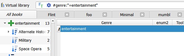

This search, produced by the tag browser when the single green plus is showing
#genre:"=entertainment"
finds all books with the genre "entertainment" but no subgenres of entertainment.
Examples:
  • Only the top level genre entertainment. Note that the number of books shown, 1, equals the count in the total count of the category minus the sum of the count of the children:

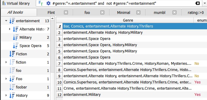

  • The top level and all its children. The number of books, 13, equals the total on the top level item:

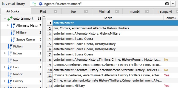

  • Only the children. This search combines the 2 above searches. The count, 12, equals the sum of the counts of the children:

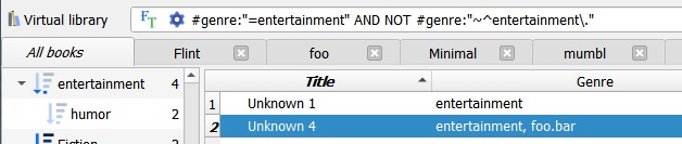

Putting the two together, the search
#genre:"=entertainment" AND NOT #genre:"~^entertainment\."
builds the intersection we want
top_level_set ⋂ ~set_of_children

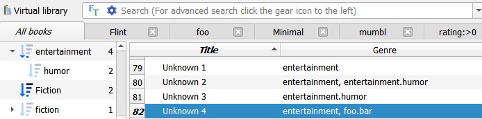

These screen captures shows that the search works. The first shows the books without a search. The second shows the books after applying the search.
ID:	206376   Click image for larger version
