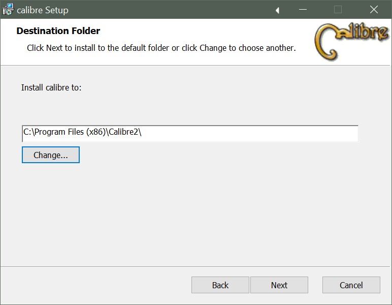

Posts: 22,889
Karma: 34252744
Shouldn't that be just (drive:\) Program files?
The installation will create / look for calibre2
FWIW: the default is:
Name:	Screenshot 2024-01-20 082133.jpg
@woodr2011 - What sort of device is mapped to drive E:

I just uninstalled calibre from the default location on C:, created Program Files directory on D: and installed calibre 7.4 at D:\Program Files\Calibre2.
Install was fine, and calibre worked fine, it picked up my existing config and libraries. So I did the reverse to reinstate calibre on my C: drive, install was fine and calibre is working fine.

I doubt it will, IMO something has gone awry with the data that the Windows Installer stores in the registry.
If you have a gig to spare on drive C:
  • uninstall from drive E:
  • make sure it has really gone - i.e. no E:\Program Files\Calibre2
  • install at the default location - see post 6.
If that works it might mean the Installer has cleared the 'blockage' in the registry. You won't know that unless you uninstall from C: and reinstall on E:. Or you might want to let sleeping dogs lie and leave the calibre programs on the C: drive. There's no intrinsic advantage in having the calibre programs on the same drive as the calibre libraries… if anything the opposite is true.
