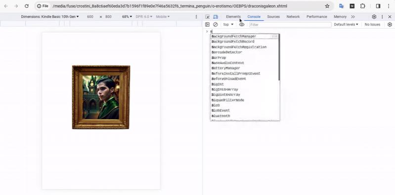

I made two gifs with the before and after for better understanding.
The result I want is being displayed in the "after" gif.
Note that I had marked my stylesheet.css in the header as a comment, to show you how the svg was behaving before incorporating your css suggestion. After removing the comment, the css came to contribute to the final result.
I must thank him for that.
It's resolved.
