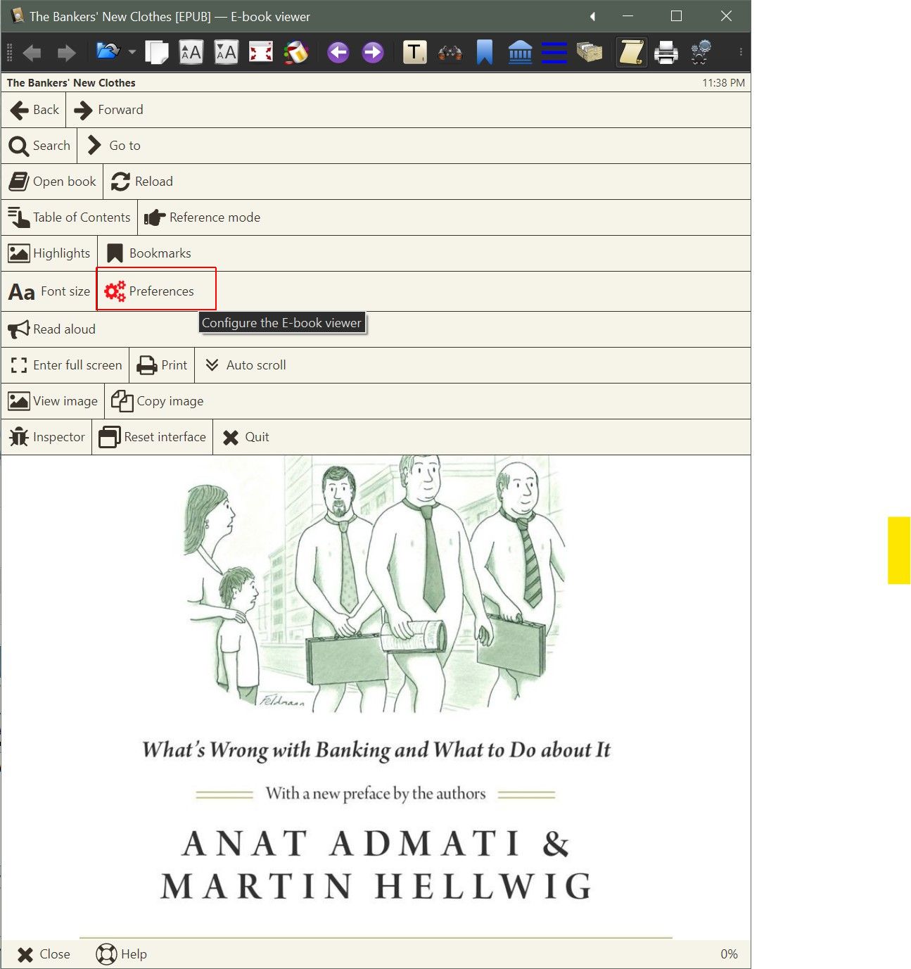

See ==>> Preferences->Keyboard shortcuts->Read Aloud in the Interface section.
BetterRed, I don't see the shortcut you indicate, see the screenshot below:

[QUOTE=pat-emmabuntus;4390645]BetterRed, I don't see the shortcut you indicate, see the screenshot below:
BetterRed, sorry, I found this in the local preferences window at the viewer and it's CRTL+s.

It's in the Viewer's Preferences:
Name:	Screenshot 2024-01-20 233845.jpg
ID:	205910 ==>> Click image for larger version
Name:	Screenshot 2024-01-20 234142.jpg
The Book Viewer and Editor are discrete programs that can be run independently of the Library manager; so, they have their separate Preferences settings.

Thank you BetterRed for your advice and it works well.
