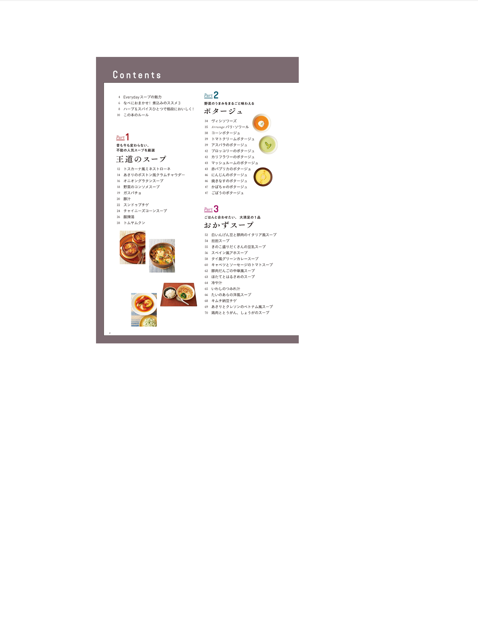

Just as it says when I convert my AZW3 files to PDF the out PDF has very small images.
Is this a setting or plug-in that I am missing? It was not like this before.
I have attached images. Any advice would help. Thank you

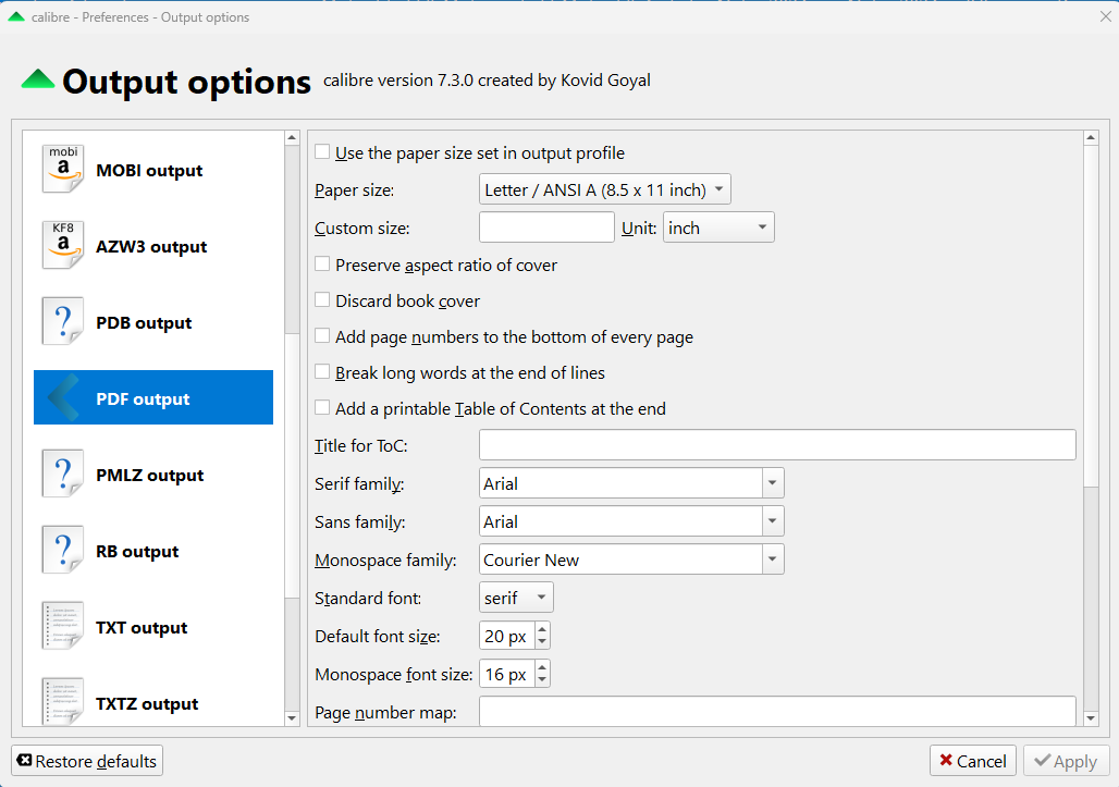

Bit of a long shot, but if the AZW3 is reflowable, you might want to take a look at the PDF output options, what paper size is set? Preferences => Conversion => Output options => PDF.
Note that if you have already converted an ebook, the conversion settings will be saved. Easiest way to fix this is to select all books, right click => Edit metadata => Edit Metadata in bulk, check the Remove stored conversion settings for the selected books and click OK.

Thank you for the reply. I converted the same books before with no problem so I know it is not a file issue. I am setting up Calibre again and just tried converting old AZW3 files I had to make sure everything was working properly and I ran into this issue as I recently changed my computer and reinstalled Calibre from new. I guess I can go back into my Time Machine and open Calibre from a year ago and check the output settings.

Thank you. I have tried all the settings and it still comes out the same way. Small image in the left corner. I use version 6.2.1. and it works fine for conversion. Not sure what the issue is but hopefully it will fix itself with future updates.
