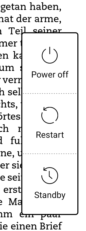

Occam's razor says that the simplest answer is the best answer.
Maybe the power button is stuck on?
When it cycles do you ever see that little dialog-ette with Power off & Restart?
The button isn’t stuck. I don’t see that little dialog box unless I press the power button and it doesn’t come up while it’s power cycling. I’m also able to use the power button when putting the device into recovery mode, which requires five distinct presses of the power button. It’s functioning as it should.
