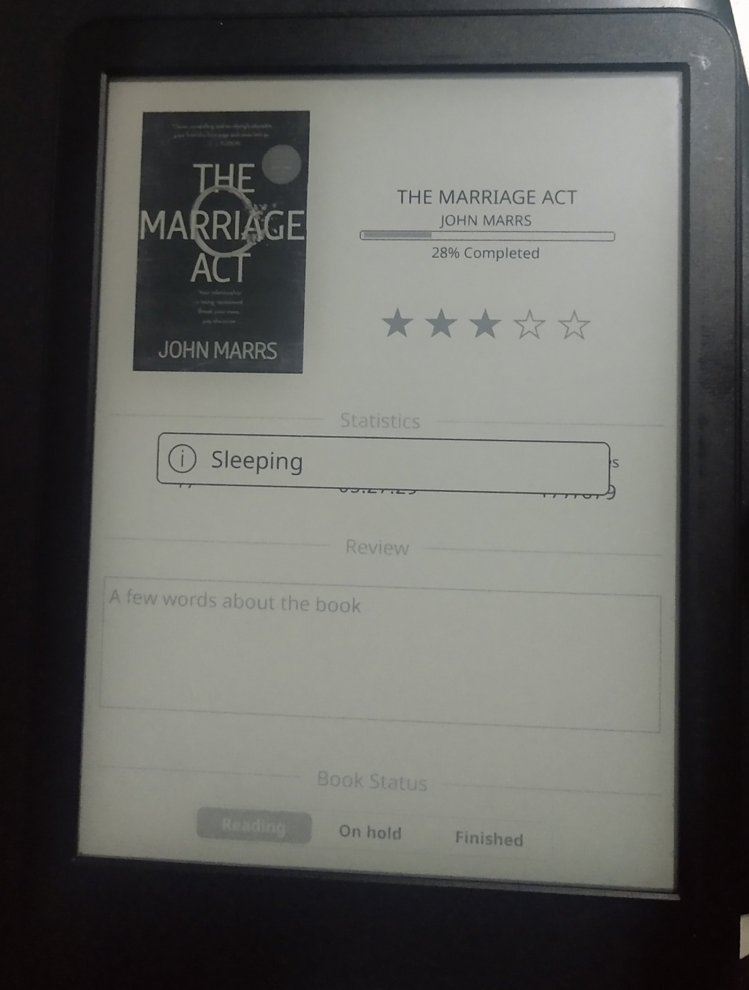

Kindle Basic stuck on KOReader screen saver and not rebooting.
I managed to jailbreak it using the latest jailbreak for FW 5.15.1.1
I've tried holding the power button for 20, 40 seconds, the device is still not rebooting. It seems to be stuck in sleep mode or something
I've attached a picture

A hard-reboot attempt not doing *anything* is fairly suspicious. Keep in mind the long-long-press is actually a hard *poweroff*, not a hard *reboot*. You'll want to follow with a tamer long press to actually power it back on.
What happens if you plug it to a *wall* charger?
@arooni: Irrelevant, if the device is in suspend or hibernation, well, it's in suspend or hibernation, it's dead to the world until awoken.

When plugged to a wall charger the device simply starts charging but it stays in sleep mode.
The constant long press of the power button ended up draining the battery as the screen's lights kept flashing. It switched off and i let it charge back up to the point it could switch on again. That's how it came back to life.
Could it be related to KOReader remaining opened for days? I hardly ever close it unless i wanna grab screenshots/send files through Kual file browser

I saw on Amazon's forum that somebody had the same issue and they suggested that plugs the kindle to a wall charger and press-hold the power button for 20 seconds.
I did the same but kept mine pressed more than 2 minutes (20 seconds solved nothing). Somehow i ended up with the battery low icon on the screen instead of what's on the picture i upload. I let the device charge, 5 ~ 7 minutes later it switched itself on normally.
I'm on FW 5.16.2.1.1

Userland has no say in the matter once the device is in suspend or hibernation, so KOReader should be an absolute non-factor here (especially on Kindle, where we don't handle *any* power management, everything's deferred to the native system, so it behaves exactly as usual).
