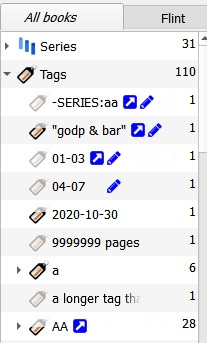

I am considering adding icons to the tag browser item lines indicating whether that item has notes or links.
Like this:

Old 12-16-2023, 12:45 PM   #2
un_pogaz
Chalut o/
un_pogaz ought to be getting tired of karma fortunes by now.un_pogaz ought to be getting tired of karma fortunes by now.un_pogaz ought to be getting tired of karma fortunes by now.un_pogaz ought to be getting tired of karma fortunes by now.un_pogaz ought to be getting tired of karma fortunes by now.un_pogaz ought to be getting tired of karma fortunes by now.un_pogaz ought to be getting tired of karma fortunes by now.un_pogaz ought to be getting tired of karma fortunes by now.un_pogaz ought to be getting tired of karma fortunes by now.un_pogaz ought to be getting tired of karma fortunes by now.un_pogaz ought to be getting tired of karma fortunes by now.
un_pogaz's Avatar
Posts: 719
Karma: 721246
Join Date: Dec 2017
Device: Kobo
Oh, that a good addition. Thanks.
But, I'm not convinced about putting the icons to the right of the numbers.
A "right of number/left of number/right of name/left of name" comparison would be nice.
There lies madness. Going down that path you would need to somehow specify the position for each possible component on the line: text, count, average rating icon, link icon, and note icon. Not somewhere I want to go.

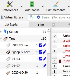

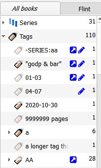

After using it a while I put the count (the number) to the left of the icons. IMO it makes more sense there. It looks like this:

I dont really see the utility of this, hence I would want it off by default. When would one want to eyeball a list of categories to see which ones have notes?
When browsing a category to see if any are left out because I forgot to add them? Or to know if I had managed to add the notes I wanted to add? Or because I am curious about what the note is but don't want to open Browse Notes? With the context menu actions one can easily maintain them.
I am OK with making the default "Off" although TBH I think that discoverability make "On" a better choice.
All the above said, I am not going to push hard to get this into base calibre. If you don't want it, that's OK.
Attachment 205280
Um, avoiding the shift of the number of elements was what I would have liked to avoid (it can make a gap which I find ugly), but since the others don't seem to fit or be problematic, I'll go with it.
Thanks
There are realy handy if they are clickable like the icons in the "Book detail". Mutch better than browse the huge tables "Manage authors/tags" (even with filters).
After that, I agree with deactivating them by default, but rather because this would overload the Tag Browser, which is already dense, so this choice should be left as much as possible to the user.
An example: If the user has assigned a lot of links or notes, if the icons are activated by default, the change in the Tag Browser rendering would be brutal and unsolicited. Deactivate by default, we keep the previous look during the update, and the icon appear only if the user want it.

That abandons vertically aligning the icons, which works if one isn't too compulsive. It also avoids wasting space for empty icons.
For fun I will look at whether it works with clicking the "buttons" (knowing what part of the line is an icon), and how it works when the text is too long to display it all. If it works, and assuming Kovid accepts the changes, the crowd can decide which version to use.
