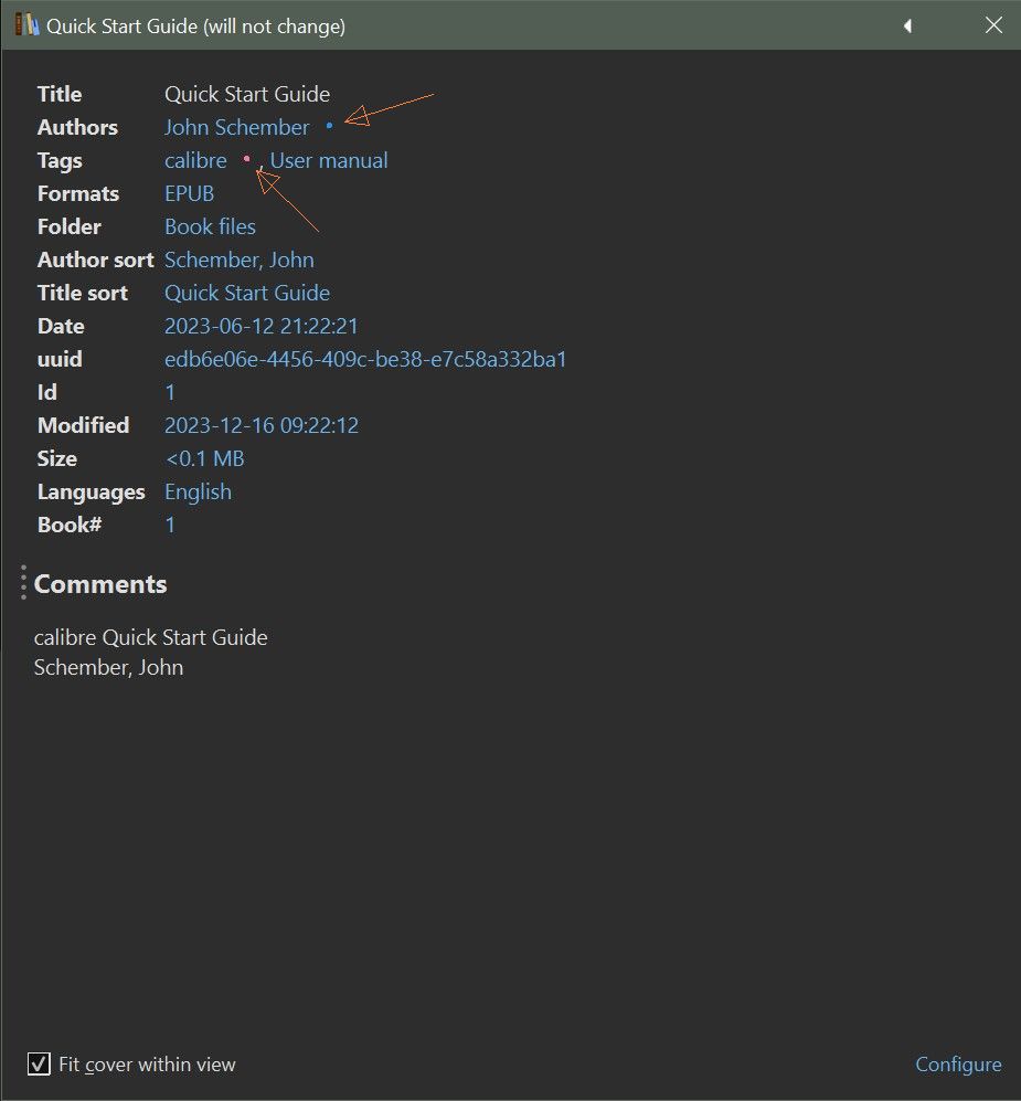

I override the pencil icon that signals the existence of a Category Note in Book details with a less intrusive small red dot.
I would like to have something similar in the book list alongside annotated categories, it can't be done with a column icon because they apply to columns, not to items within a column - e.g. an Author, a Tag, etc.
I use a small blue dot for Category Links, for the sake of completeness it would be good have something similar for Linked items the Book list.
Assuming there's no existing way of doing it, and would require a new feature to be developed:
IMO it would need to be something less intrusive than the default note and external-link icons. For illustrative purposes I am attaching my red and blue dots, and a screen shot of their appearance in Book details.
And, for consistency, a checkbox in Look & feel->Main interface - "Show indication of links and notes on category items in the Book list" should be provided.

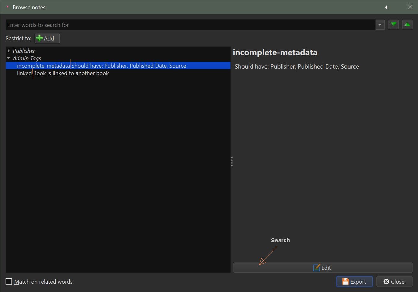

No I meant more like a dot/mark in the corner of the icon. Left corner for notes and right corner for link.
I dont really see the utility of this, hence I would want it off by default. When would one want to eyeball a list of categories to see which ones have notes? And if you make them separate icons people are going to expect to be able to click the icons to edit the notes/links directly as happens in the book details panel.
The Browse notes tool does that.
Be good to have a button to initiate a book search for the currently selected item - I wouldn't suggest taking it further than that. And clearer demarcation between the item name and the note text in the list - e.g. a separator, distinctive font or colour. See attachment.
Agreed. A button to display all books with the selected author/tag/etc, would be welcome.
I love this Browse Notes. Very handy for seeing all the notes at a glance.
