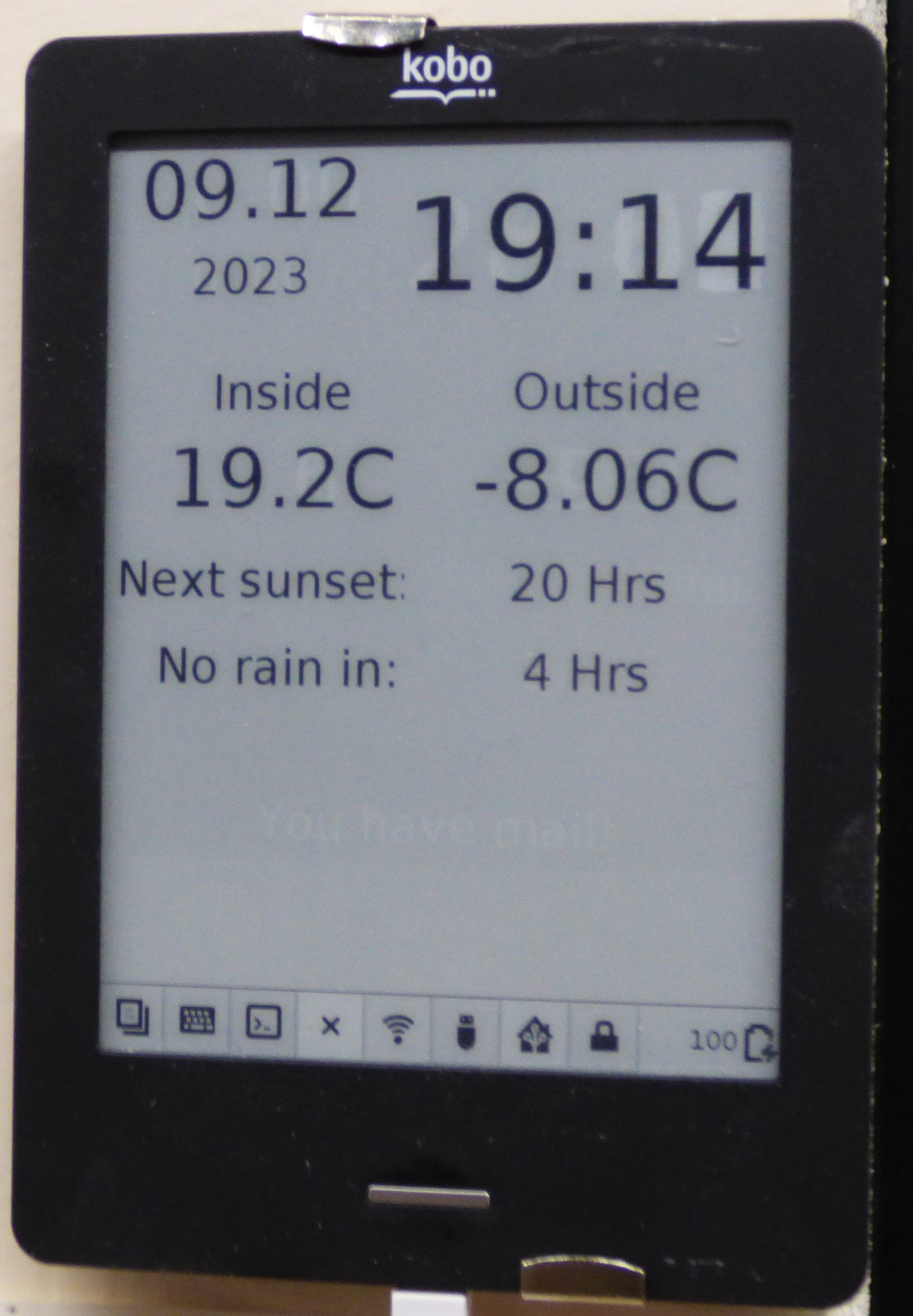

I took kobowm image made by pasqu4le ( and marek) and wrote simple python script to read MQTT messages and show them in dashboard. It also sends back battery information. I use it with Home Assistant but of course can be used with anything that speaks MQTT.
Instructions for installation and code in:
https://github.com/MarkoMarjamaa/HA_Kobo
And thanks for the tons of information I've got from this site.
Sorry for the oversized picture...

AWESOMESAUCE! I was literally just looking for a way to use my old Glo HD as an e-ink dashboard with HA. Would this support my Glo HD? That would far outshine any plans to create a small e-ink friendly dashboard for the Kobo browser.

I have no idea if it works in Glo HD. Depends if you can run the KoboWM image I used as foundation.
