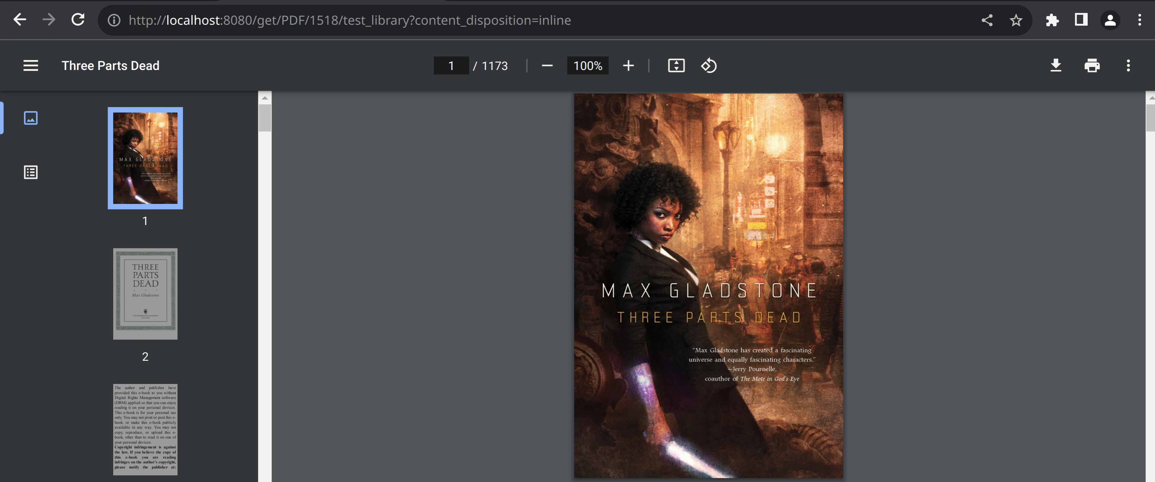

Works fine for me with chrome, see attachement. The read button causes the browser to open the PDF file from the server with a URL that causes the server to set the content-disposition: inline header. If your browser supports PDF and content-disposition, it will open in the browser, if not it will be downloaded.
