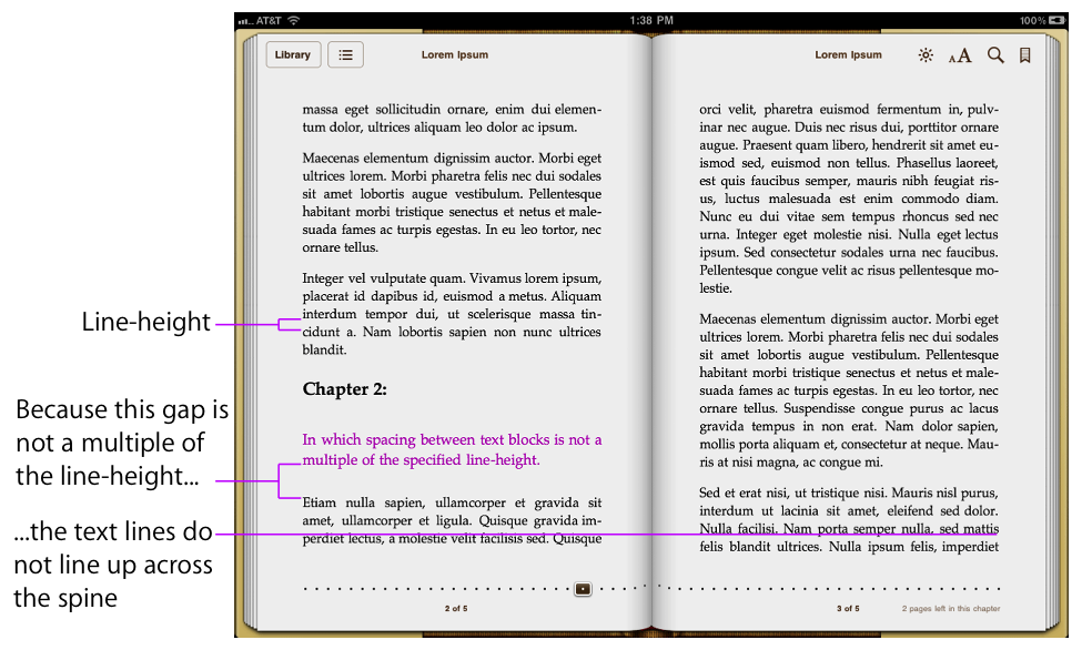

Apple Books Asset Guide states the following:
Alignment
If specifying line-height, extra spacing between text blocks and any padding around images should be a multiple of the specified line-height to keep text aligned across the spine.
It goes on to state that iPads will show facing pages when turned to landscape mode. Kobo states the same behavior with their readers, and ADE will show two pages when the width of the reading window is extended.
I'm just trying to follow their guidelines, since failing to do so may be grounds for a book submission to be rejected. Personally speaking, I think the requirement is an error. It may be possible with a fixed layout book making use of their javascript libraries, but it's not really practical to implement for a flowing book.

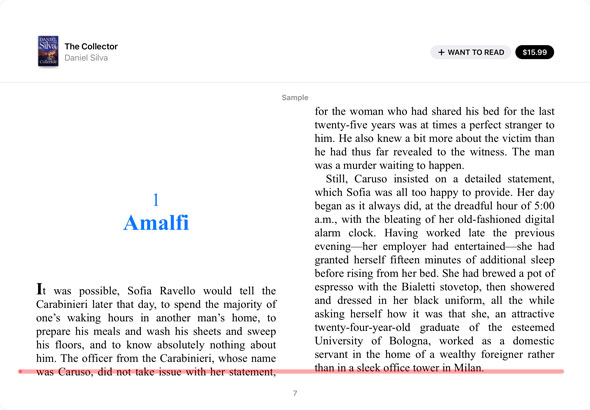

I took a look at a sample of a popular book in the Books app on my iPad and alignment across the spine for a two page spread was not maintained.
Thanks for the information. I won't worry about this issue now. I couldn't find a way to do it, but thought there must be a way if Apple is asking for it to be done. I guess they'll have to wait for CSS4.
