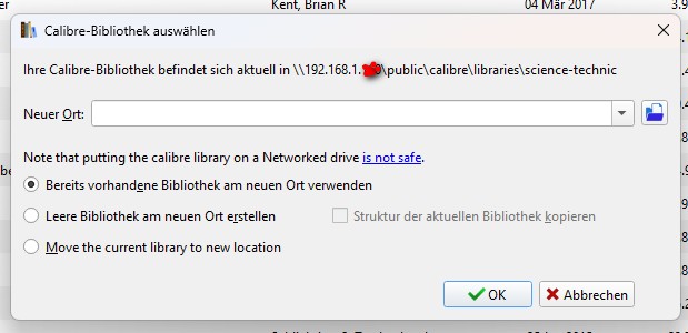

but the raspberry function just as file server, and why it worked for 10 years fine, and why can load all other libraries I have on the raspberry/HD?

for example, see pic...load my science lib with no prob
