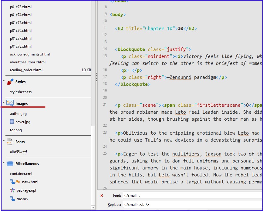

Originally Posted by andhistablet View Post
but the image referenced here is not in the file (that I know of). Not sure how to check.
<img alt="111411528" id="d5e89" src="images/jonathan strange (searchable)_0001_002.jpg"/>
The image link seems to be pointing to a local image.
To check what images are in the epub file, look under "Images" in the left panel. See image below.
Are the images there?
