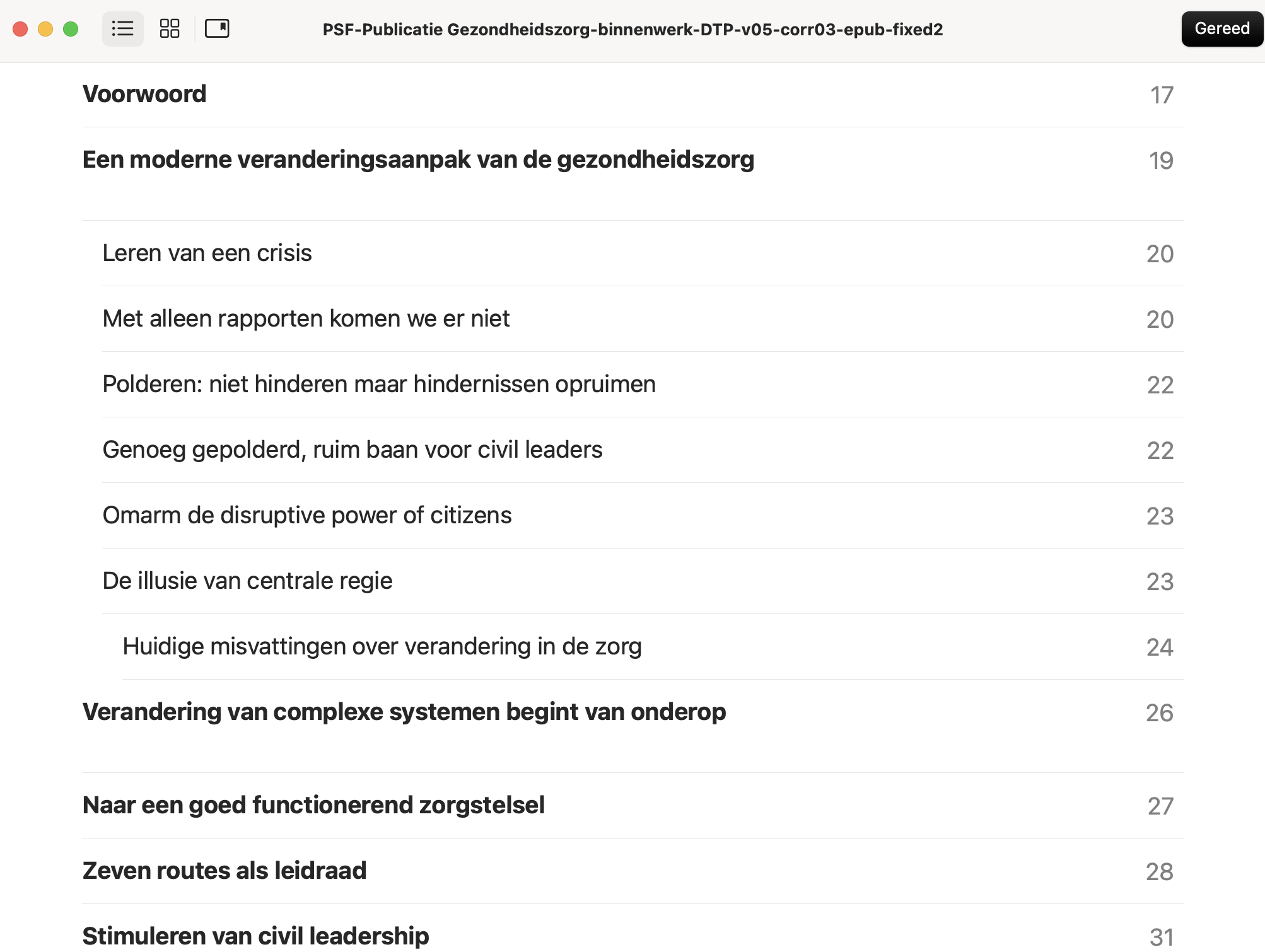

I've designed a ePub with a nested TOC. The problem I run into is that Apple Books is showing the levels incorrectly in the TOC. This is only happening with Apple Books. Other platforms seem OK as far as I can see.
The problem occurs when jumping 1 level back from a nested level. The program immediately jumps back to the beginning (main level) and not 1 level back. Thus showing the Paragraph heading in Bold. Thinking it's a chapter and not a Paragraph.

TOC as shown in ePub Apple Books:
png.gif inhoudsopgave via menu.png (218.9 KB)

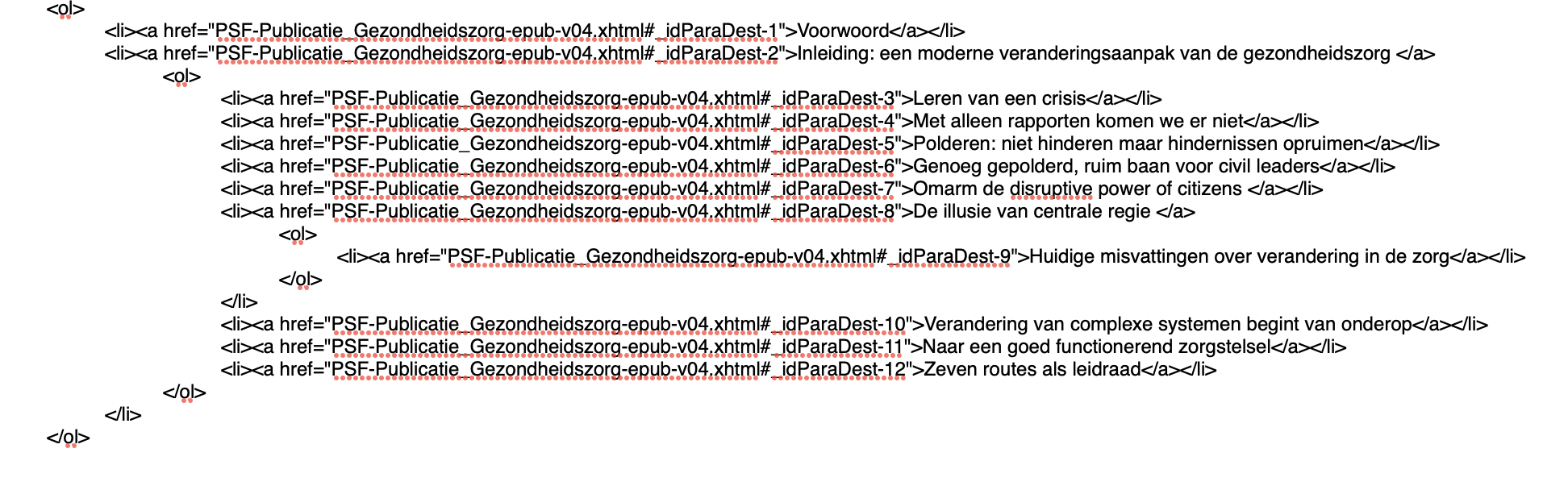

Here is an image of the toc.xhtml code:
png.gif Screenshot 2023-05-12 at 10.45.22.png (342.6 KB)
Hope somebody knows what I'm doing wrong.

I'd recommend not using lists, but simple nested <div>s, or level-specific classes.

Did a quick web search and found this bug report from 2016.
https://discussions.apple.com/thread/7419388
It had no answer. It appears to be exactly the same bug you are asking about. So my guess is this is a very long standing bug in how Books builds its toc from the NAV that Apple has no interest in fixing.
You might try simplifying it to be a 2-level level or just a 1-level NAV, then create a non-NAV xhtml table of contents to show the user that is more complete.

Thanks for the tips! That old bug is exactly what I'm running into. Thanks for sharing.
I'll try the other readers and see if the TOC works correct. I also try to simplify the TOC.
