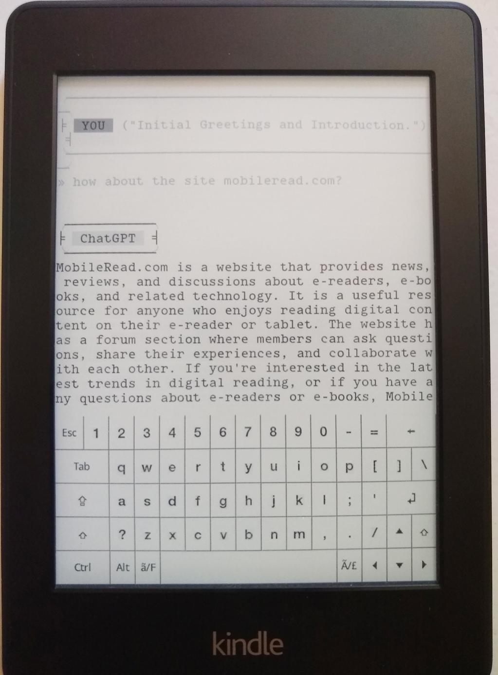

After a period of struggle, I finally managed to run ChatGPT successfully on Kindle. Here are the steps I followed:
1. Download the Bash file and copy it to the root directory of kindle (/mnt/us).
2. Modify the header of the AI bash script file to #!/mnt/us/bash.
here's the modified file, there might be some issues as I'm not familiar with Bash, so...
ai.zip

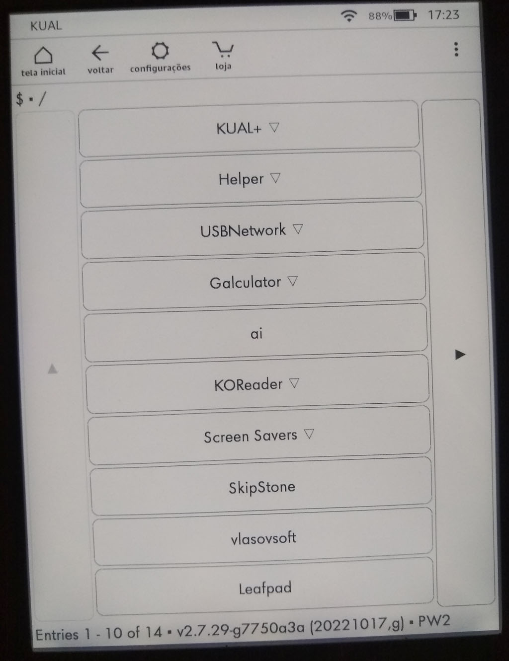

also, you can edit menu.json of kterm extension to add a menu item in KUAL, it will like a real app.
kterm_menu_ai.zip
