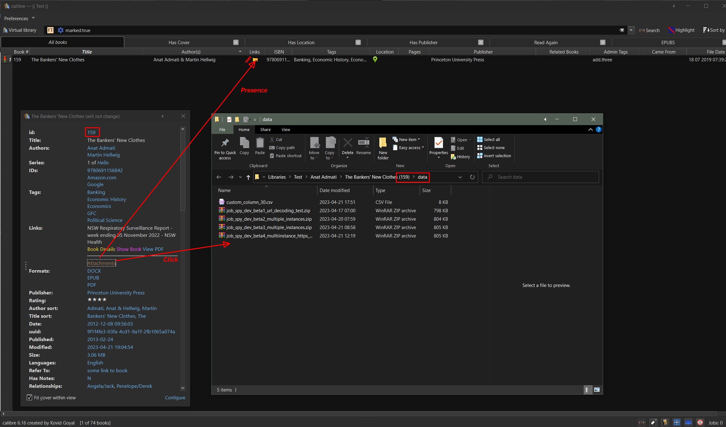

@un_pogaz You could do something like this.
Name:	Screenshot 2023-04-21 192431.jpg
I have this in my Links Column
<p><a href="file:///D:/Calibre/Libraries/Test/Anat%20Admati/The%20Bankers'%20New%20Clothes%20(159)/data/"><span style="color: #9e7852">Attachments</span></a></p></

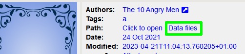

Attachment 201153
Doesn't the link that Kovid added in the above commit do this job? The "Data files" link is there only if the book has extra files.
Does this check for presence of files, or just the presence of the folder (even if empty)?
Old 04-21-2023, 06:15 AM   #10
chaley
Posts: 12,529
Karma: 8125420
Location: Notts, England
If the 'data' folder exists and contains anything (files or folders).
