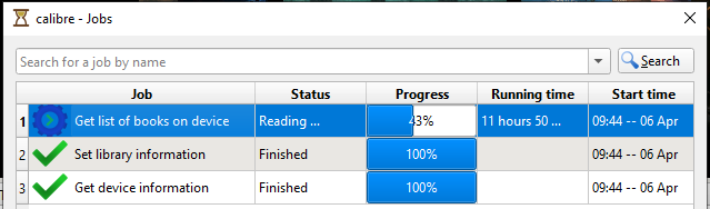

Almost twelve hours in and it's at 43%. I don't understand why it is so slow. As mentioned, my Glowlight Plus only has a 4GB card with 2.5GB to scan.
Still, it hasn't yet crashed, so

It crashed again. I do now have the driveinfo.calibre again, but not the metadata.calibre file.
