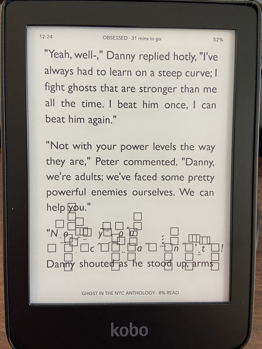

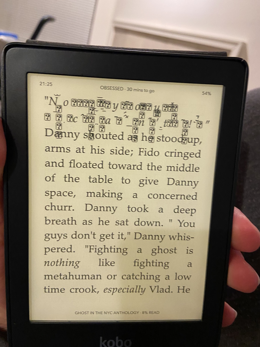

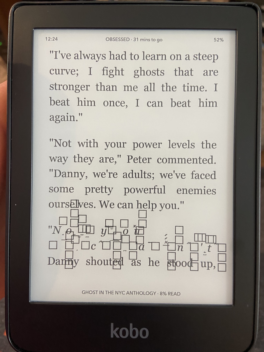

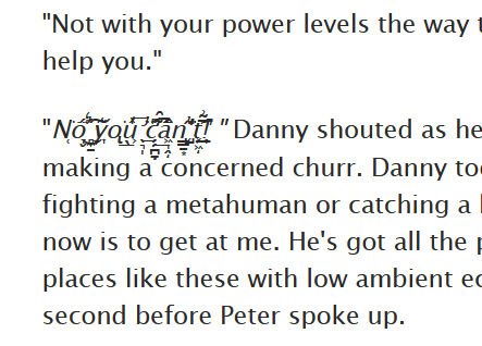

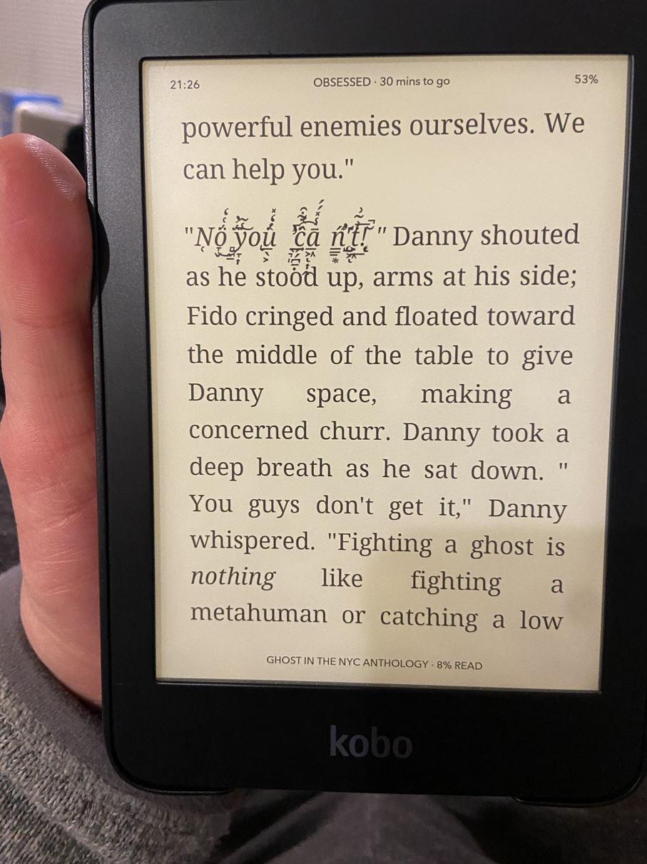

I've been reading a lot of fanfic on my Clara HD, and some authors will use "zalgo text" for spooky dialog, but it doesn't render right on my device. Typically I use Palatino as my reading font, but the rendering is an absolute mess despite having Noto Serif set as a supplemental font (see the first attachment). When I set my reading font to Noto Serif it renders just fine (see the second attachment). For reference the third attachment is how it looks in Firefox (original work is at https://archiveofourown.org/works/28092402).
Any ideas on how to fix this?

Karma: 154365103
It could be that your main font has these characters but that they are blank. What us your main font? I suggest trying another font such as Georgia and see what happens.
The font I use is Palatino, which iirc I ripped out of a Kindle Voyage update image then sideloaded onto my Kobo.
As for using a font like Georgia, same result unfortunately. I tried both Georgia and Gil Sans, and as you can see in the attached images it didn't work any better.

Old 03-26-2023, 06:03 PM   #4
Posts: 55,412
Karma: 182544230
How are you embedding "zalgo text" in your fanfic to allow your epubs to access it? As far as I am aware, zalgo text is generated by munging characters and multiple diacritical marks together and requires a Unicode font that supports all the needed glyphs and is not an actual font that can be downloaded or embedded. Those blank blocks are generally the result of a glyph that is not defined in the font you are using to display the text.
You might want to try installing the code2000 font on your Kobo and selecting it as the document font.
