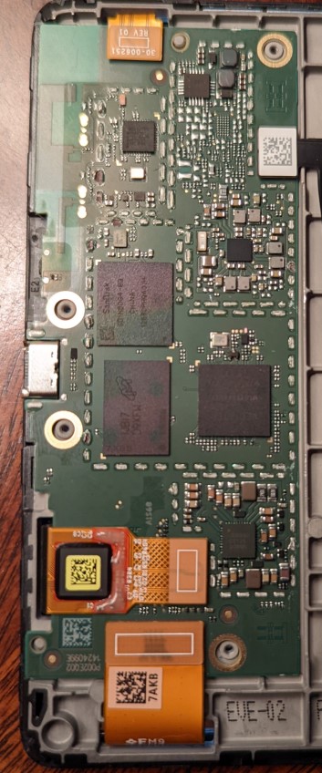

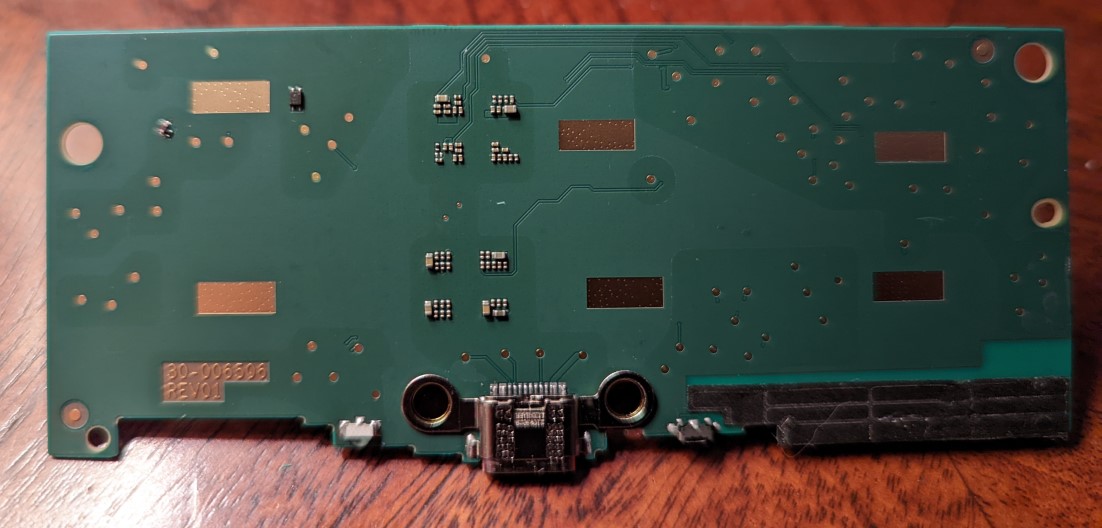

No i have not reasearched that possibility yet. I see someone on another thread posted pictures with sheilds removed. Hopfully they don't mind me repeating them here.
Images deleted.
Many rear contact ponts. I will look into it. Any advice on that route also appreaciated.

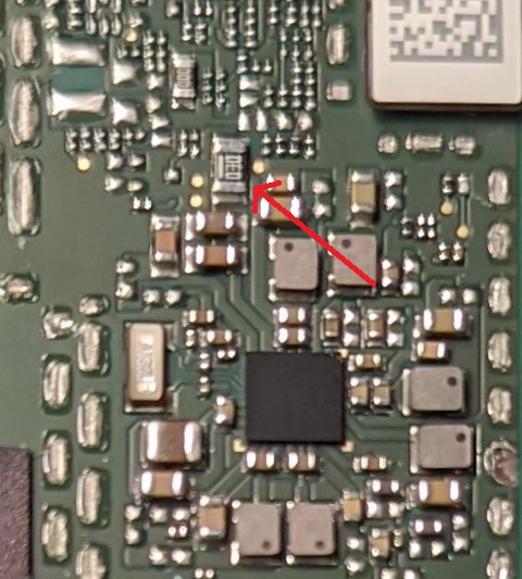

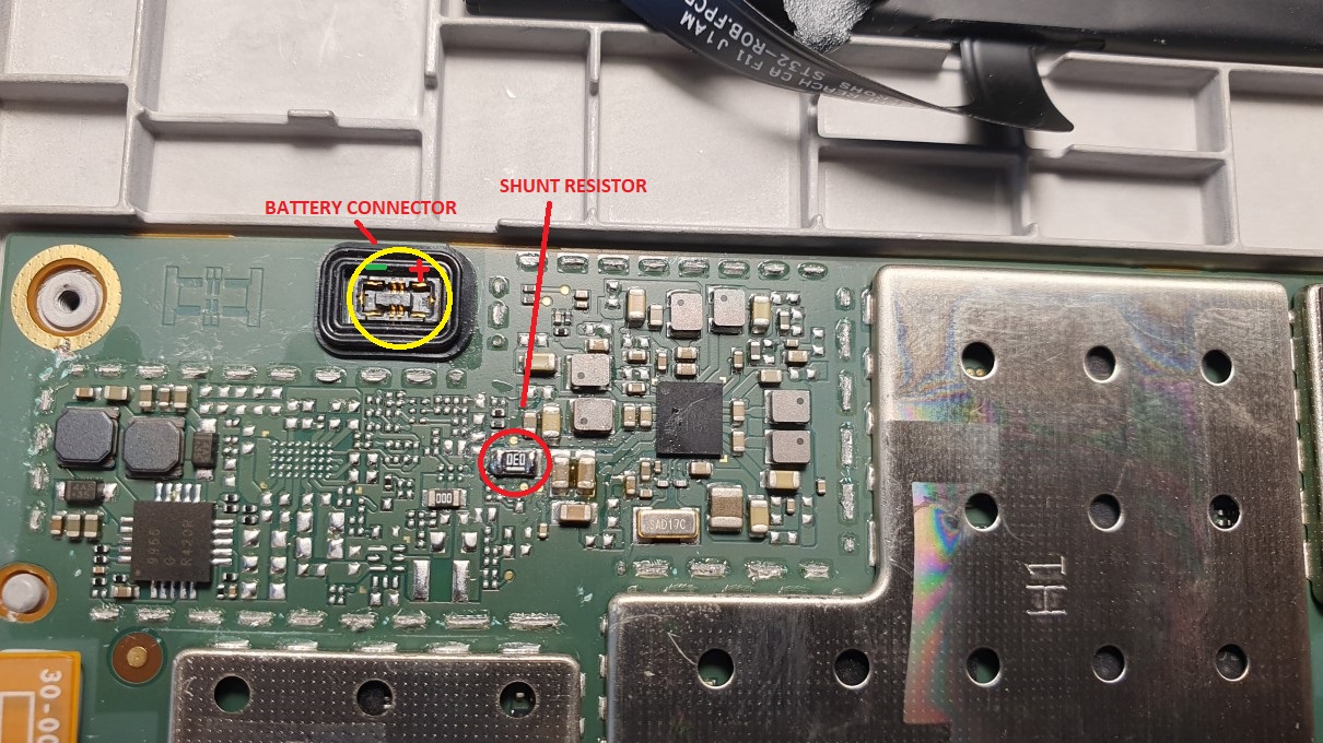

I have read from this kindle repair site common problems with a shunt resistor.
http://ebookrepairs.com/uncategorize...-not-charging/
I see it here for the PW5 (Red Arrow): I will have to remove sheild & reflow solder on that resistor. Worth a try. I also have ordered a USB to serial adapter capable of 1.8v. this looks to be a fun (ish) learning curve. Any input from experience welcome.

More discoveries in this process. I removed the sheilding And reflowed the solder on the shunt resistor. (Ugly soldering i know.) Tried turning on but has the same origonal symptoms. Shunt has good continuity. Battery neg is common with usb sheild. Measuring from neg to shunt. 0.106Volts. ??
I decided to put a ammeter & voltmeter in series with the battery via jumper leads. 4.2 volts isolated. On feeding to the battery connector it drops to 0.106 volts.
I tried some external load and the battery still holds good.
This is what i discovered. I have a momentary high current when connected to the kindle spiking above 3 amps when i feed through the battery connector. The battery protection IC shuts off leaving me with 0.106 volts. resets back to 4.2 volts when disconnected. There is a shorted component somewhere.
Image deleted.
I will search more but please share if anyone else has experience this and knows where to look.
