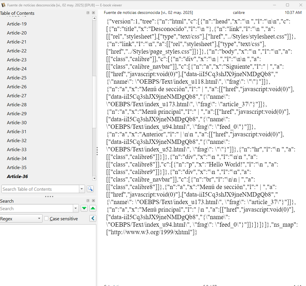

Old 05-03-2025, 01:39 PM   #13
Posts: 55,476
Karma: 182544230
Tried clicking on Siguiente and got a screenful of code at random intervals. I've attached an image of the screen.
Name:	Screenshot 2025-05-03 103808.png
