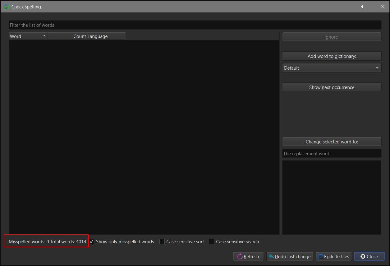

No, I'm using a single monitor
.The Spellcheck window opens and says there are no misspelled words
Ah, I think I may have managed to manufacture your situation. I'm assuming you haven't added any spelling dictionaries - is this what you get:

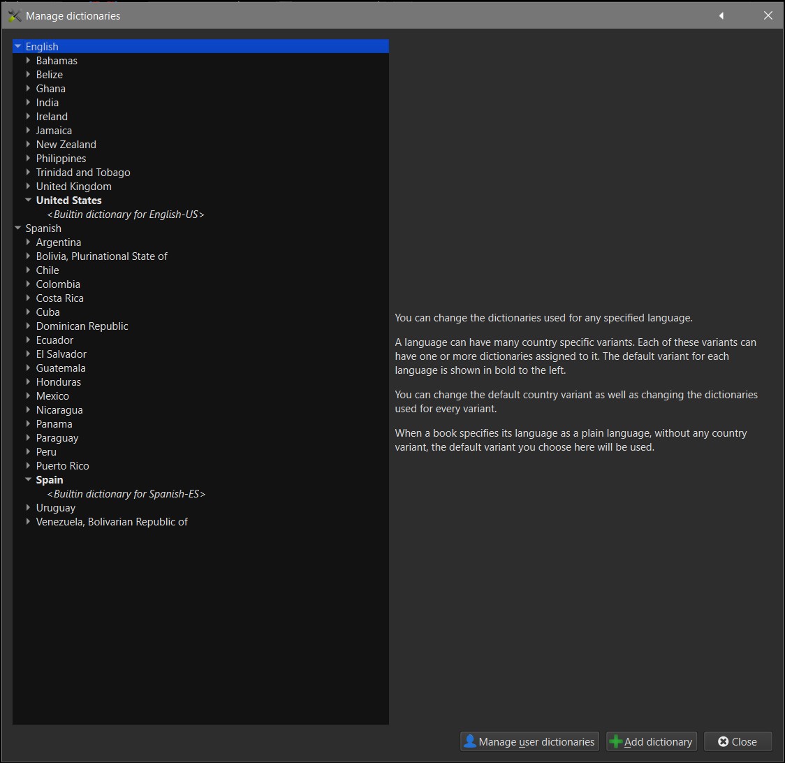

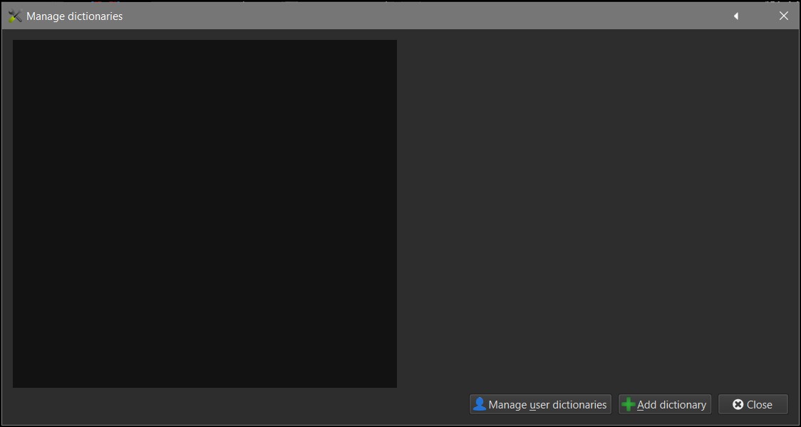

If it is, go to Edit->Preferences->Editor settings->Manage spelling dictionaries. If you get this:
Name:	Screenshot 2022-11-09 082827.jpg
…then ot would seem you have 'lost' the default English and Spanish spelling dictionaries.
Simplest way to get them back is to reinstall calibre - that means an uninstall and new install - you wont lose any libraries or preference settings in doing that.

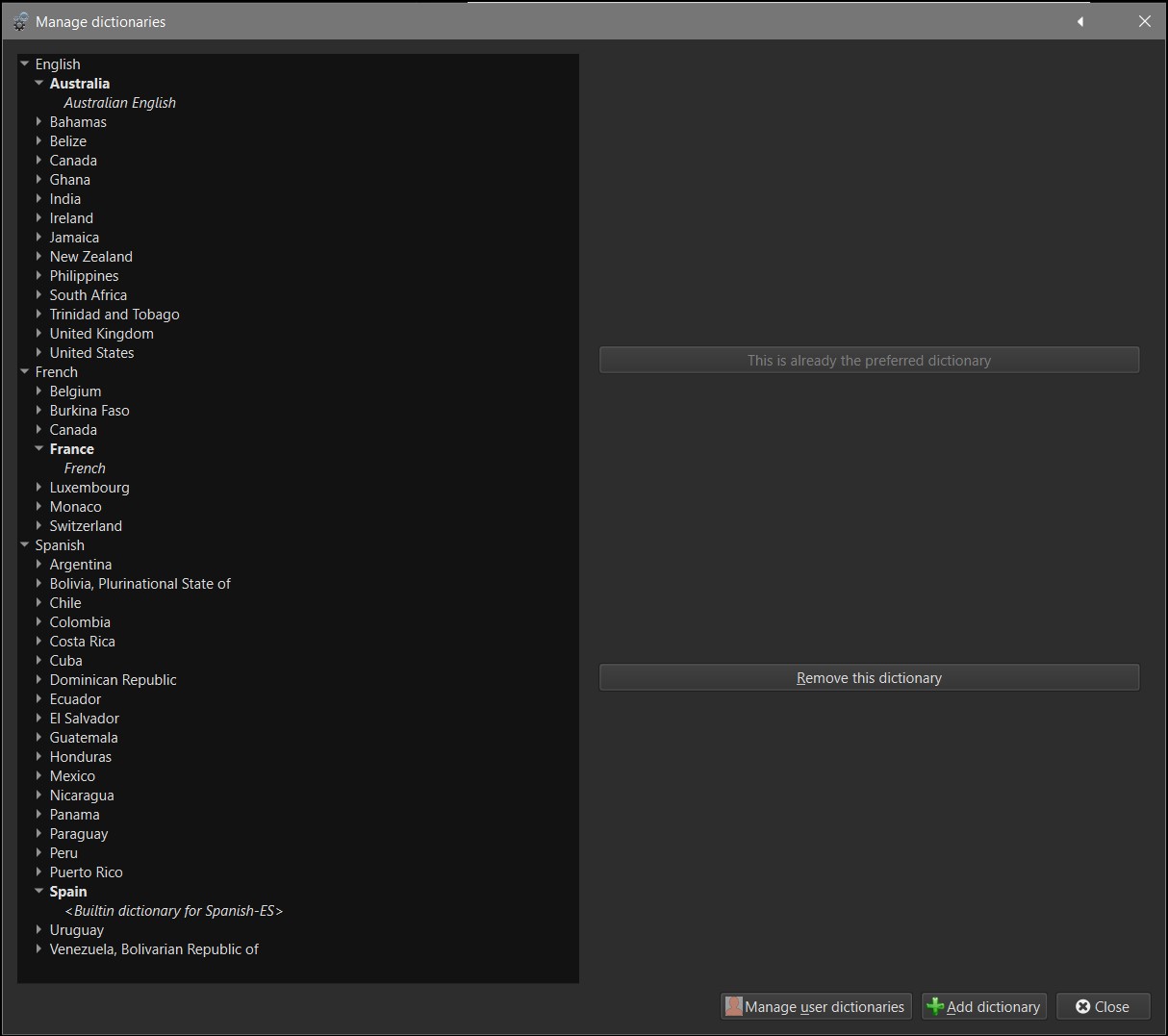

What does Preferences->...->...->Manage spelling dictionaries have in it?
I've added Australian and French dictionaries so mine has this:
Name:	Screenshot 2022-11-09 132634.jpg
