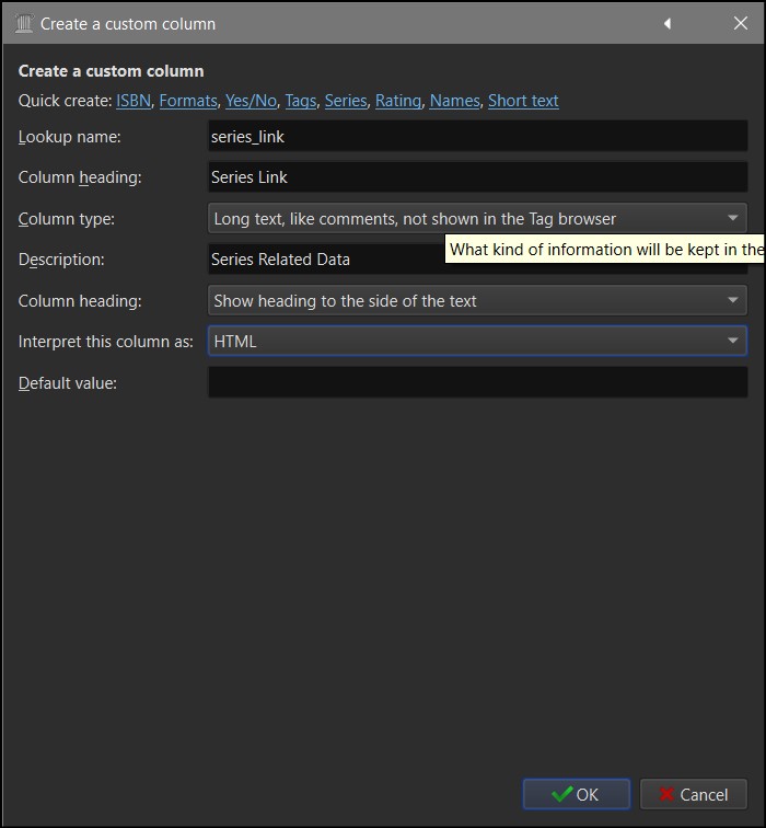

I would do this
SETUP
1. Create a custom column to hold the link(s)

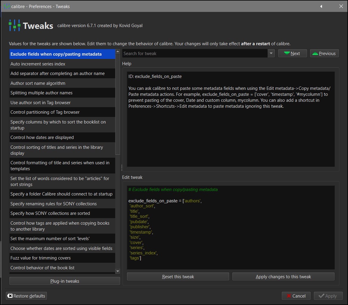

2. Set fields to exclude from metadata paste
Name:	exclude on paste.jpg
That list is not complete, e.g. I haven't put rating in the list

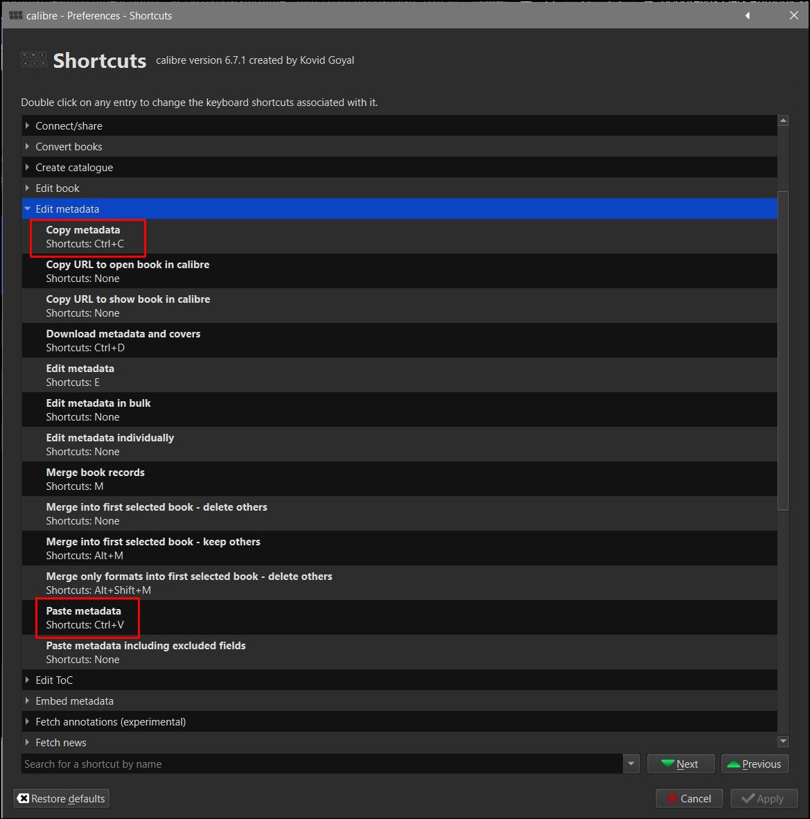

3. Set up copy and paste shortcuts (if not done already)

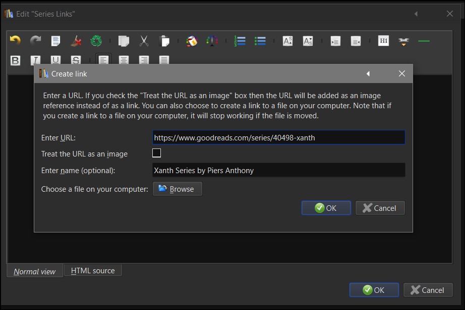

USAGE
1. Set up link for first book in Series
Name:	create link for first book.jpg

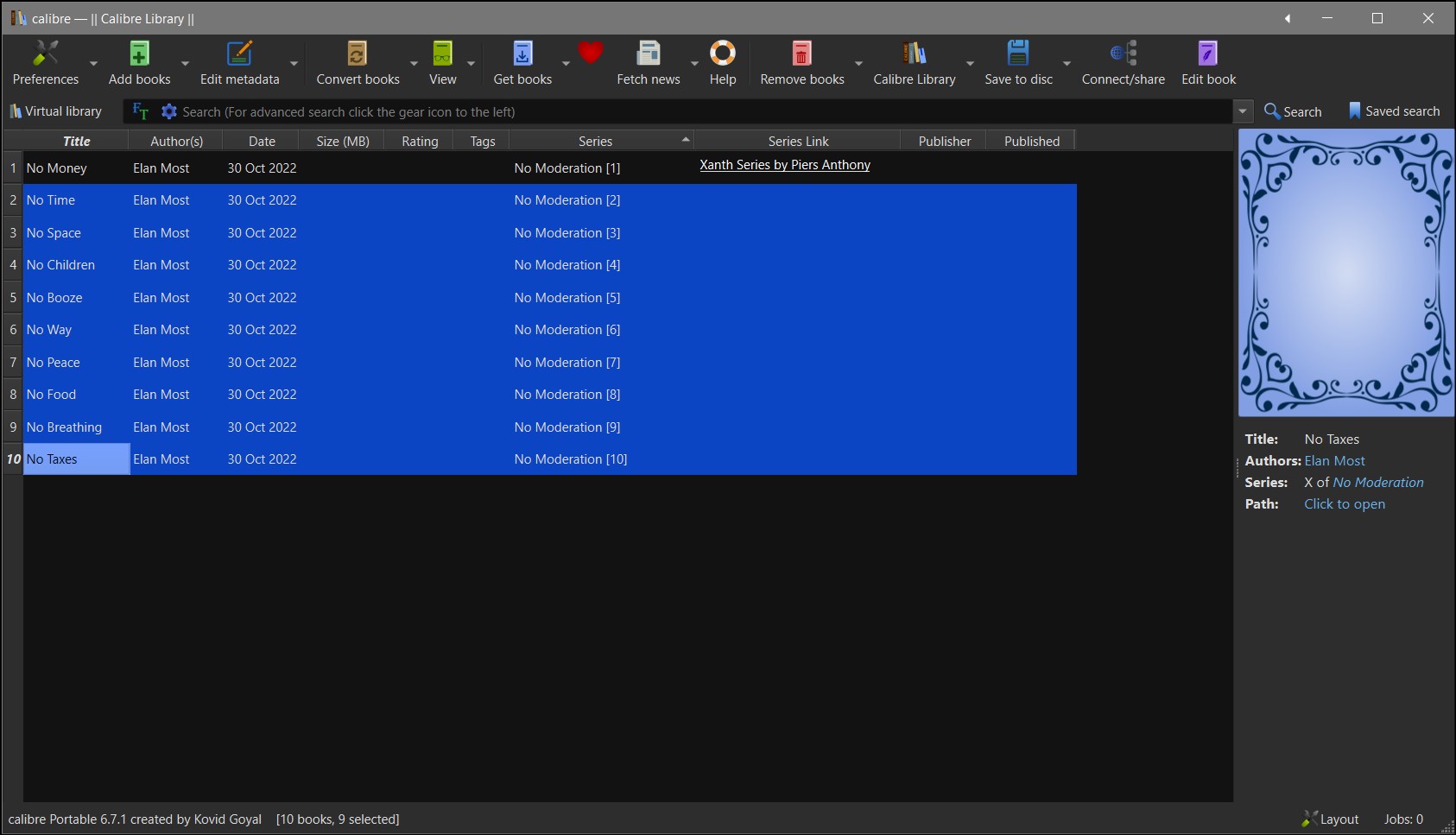

3. Select Multiple Books
Name:	select multi books.jpg

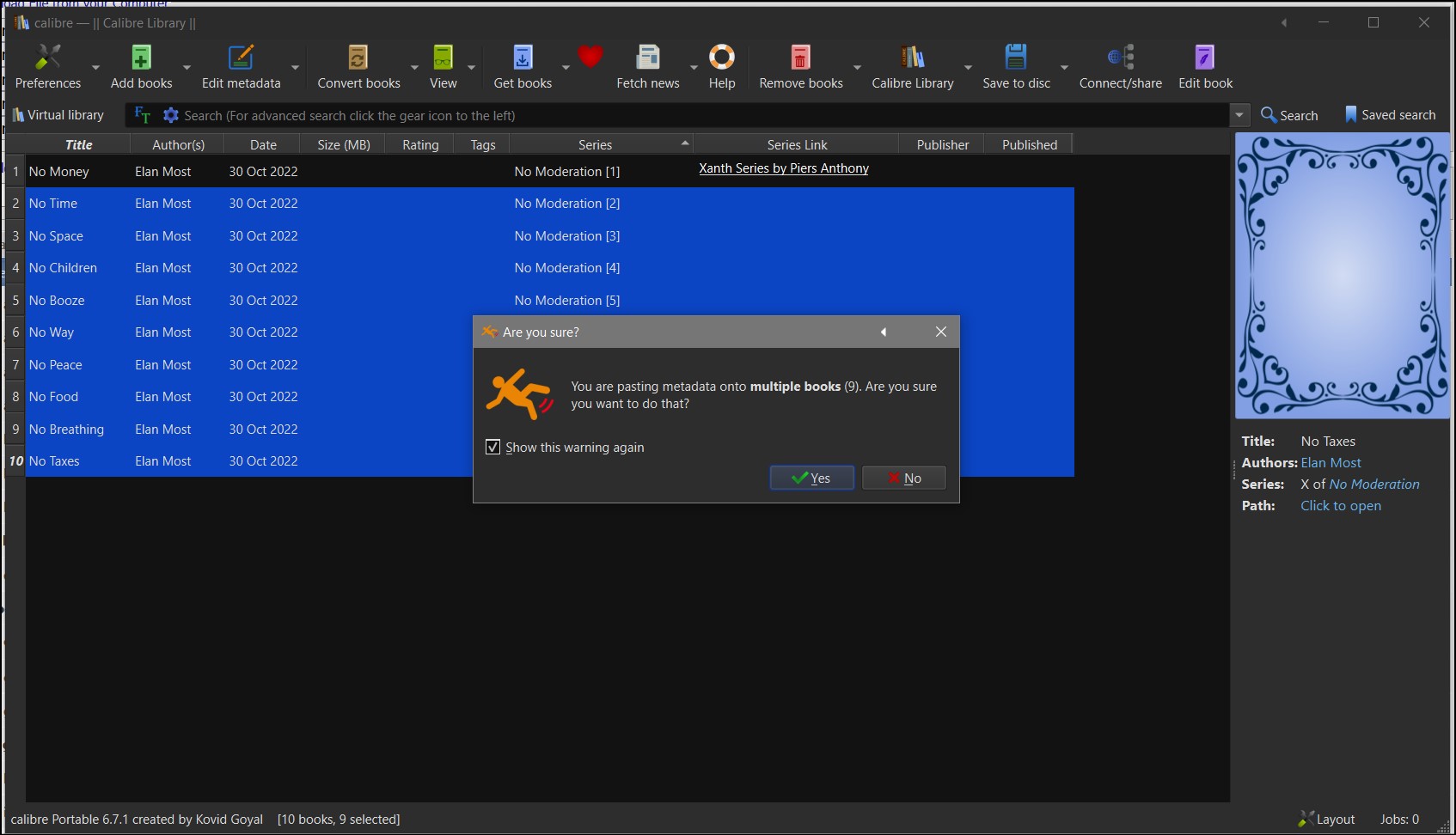

4. Paste metadata into selected books - ctrl+v

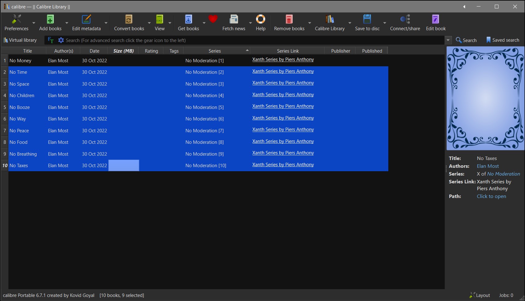

5. All Done
Name:	et voila.jpg

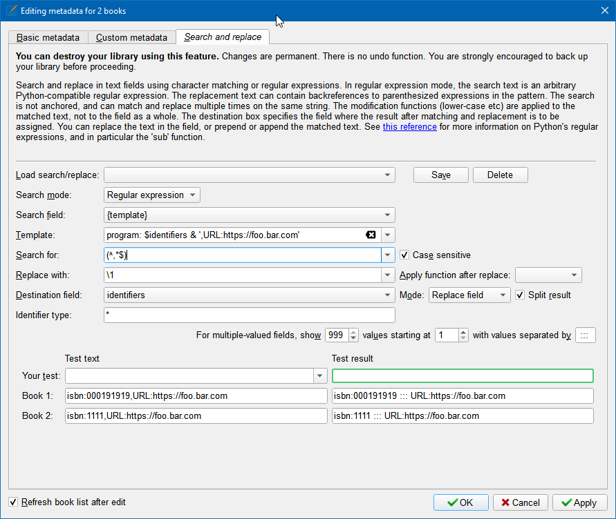

This is easy to do with bulk search & replace using template mode. Any existing URL identifier will be replaced with the one in the template.
I strongly suggest you make a backup of your library before running amok with this stuff.
