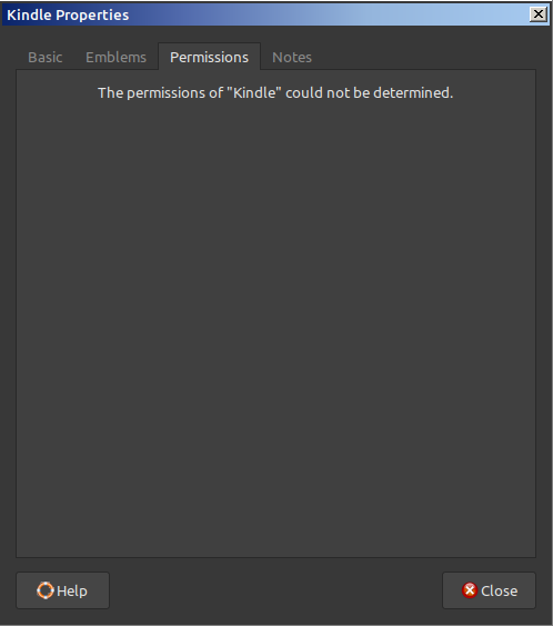

Howdy,
PC System: OS = Linux Mint, Mate, 22.0
Recently I have not been able to load ebooks from Calibre to my Kindle Oasis. I booted to a live USB for the same OS noted above and it still did not work. I have used Linux and Calibre for years with no problem until now.
Here's the error:
"The permissions of "Kindle" could not be determined".
1) How do I reset the permissions so I can restore this function?
All comments and suggestions greatly appreciated!
Thanks,
Tom

I rebooted several times, changed the cable even though Calibre see the Kindle and thinks it has successfully transferred the book. I have also swapped USB ports etc. I have rebooted the Kindle several times.
When I look at the properties via right click on the mounted icon I get the error message. When I look at the Kindle via sudo Caja I see the correct permissions correctly...

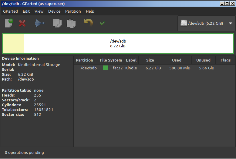

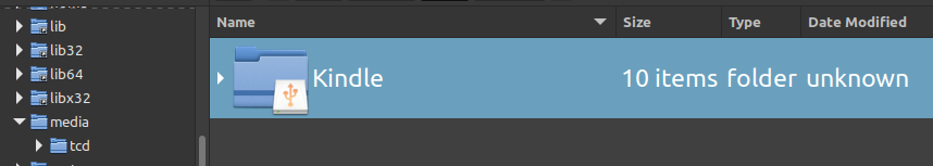

Unfortunately this has now progressed beyond my understanding. Can you tell me anything from these results?
I have also noticed that the /media/tcd directory is empty until I mount the kindle. Then is seems to id the Kindls as a USB:
Please see the attached screen clip.
Thanks VERY Much for all of your help!
Tom
PS: I would swear that I have used Calibre since I upgraded to Linux Mint, Mate 20.x. However I can't account for the sub directory "tcd" in the "media" sub directory.

tcd@tcd-yjl:~$ fsck /media/tcd/Kindle
fsck from util-linux 2.37.2
e2fsck 1.46.5 (30-Dec-2021)
fsck.ext2: Is a directory while trying to open /media/tcd/Kindle
The superblock could not be read or does not describe a valid ext2/ext3/ext4
filesystem. If the device is valid and it really contains an ext2/ext3/ext4
filesystem (and not swap or ufs or something else), then the superblock
is corrupt, and you might try running e2fsck with an alternate superblock:
e2fsck -b 8193 <device>
or
e2fsck -b 32768 <device>
Attached is the Gparted screen shot.
Maybe I should just wipe and reinstall the default Kindle OS and rebuild my ebook library which is not a big deal...
Thanks again,
Tom
