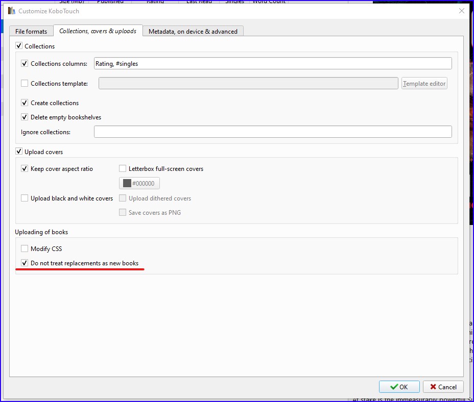

Do you have the setting in the screenshot enabled...

Join Date: Oct 2018
It's checked.
