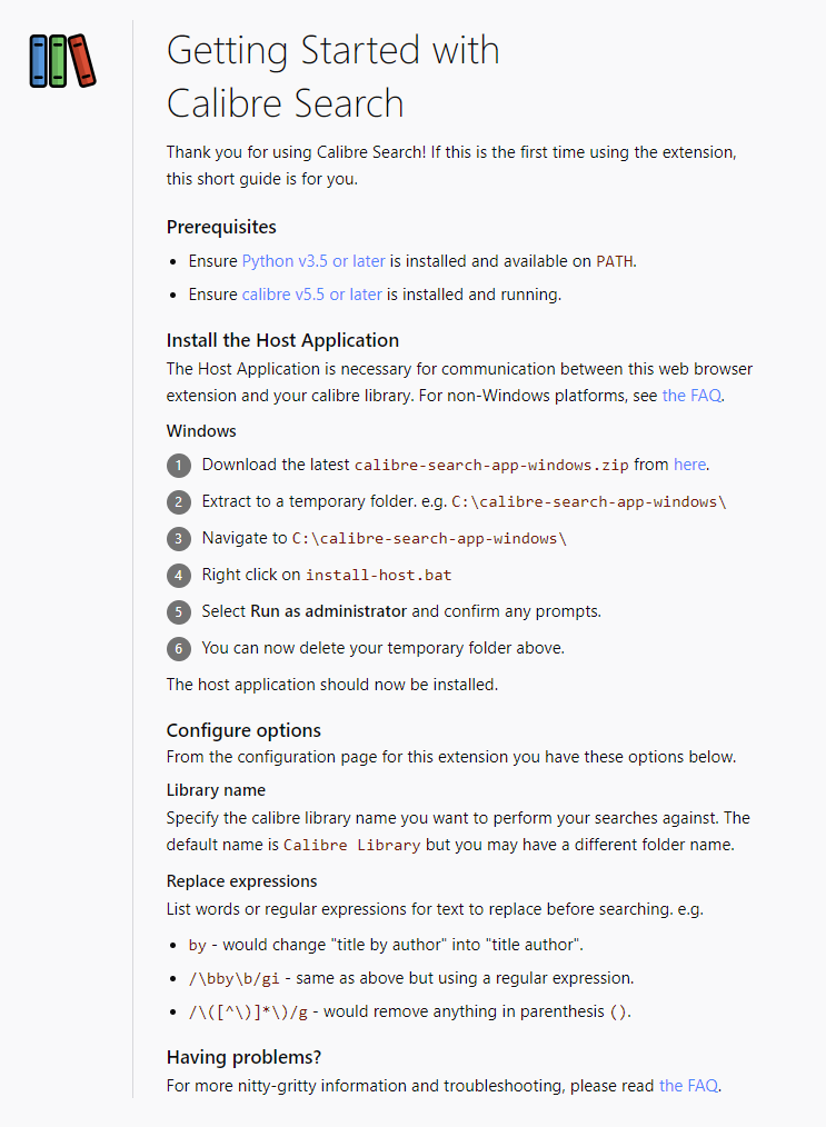

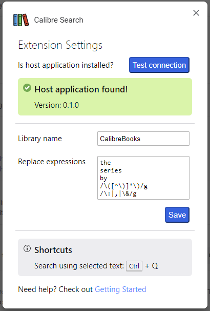

5. At this point you should just go to the Options page for the extension and follow the documentation in either the Getting Started link within that options page or the FAQ link above. So get the host application installed and your calibre library name set.

6. Chrome users Because I haven't registered this in the marketplace yet your machine will give the extension a temporary id. You need to copy that id into the following file after you have installed the calibre-search-app above using install-host.bat:
%localappdata%\com.kiwidude.calibre_search\manifest-chrome.json
The last line in the file has a "chrome-extension://XXX/" value, replace XXX with your ID from the //chrome:extensions page above.
Now you should be able to click on Test connection in the options page and see it go green...

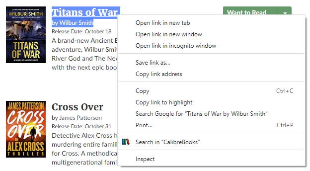

Finally you can now try searching - as shown here I could either select a mix of text and hyperlink, just text or just the hyperlink (the last case will do a search for the text displayed on the hyperlink, e.g. "Wilbur Smith").
So by default this will do a search in calibre of:
PHP Code:
Titans of War by Wilbur Smith
But with a simple replace expression of either "by" or "/\bby\b/gi" configured the calibre search becomes:
Titans of War Wilbur Smith
