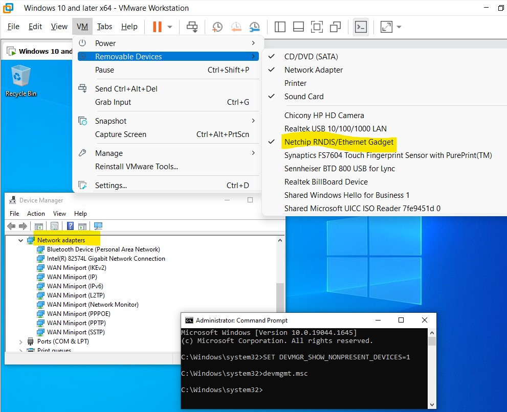

I'm attempting to get my Kindle/PW1 up and running as a literary clock.
I've managed to JB it OK running firmware 5.3.5 and have installed USBNet 0.22 - I am able to start a SSH session over WiFi and when I toggle over to USB mode I am never able to see a RNDIS/Generic network connection and therefor cannot SSH via USB. I have tried Ubuntu/Windows 11/Windows 10 all with the same result.
I need to get the USB session working as I do not know the password for WiFi (both SSHD and DropBear) - all attempts at the serial based password do not work
Is there something else I need to do to get the USB Network interface to show? (so I can SSH locally)
see attached screenshot that shows that the 'device' is seen but does not show in device manager

^ with Ubuntu this was the closest I got to getting a USB session going - still with an incorrect password. Not sure why windows refuses to see a USB network adapter though

note that Windows is seeing a USB COM port being added. (unable to telnet with it)

You need to install the driver manually
https://www.mobileread.com/forums/sh....php?p=3283986
