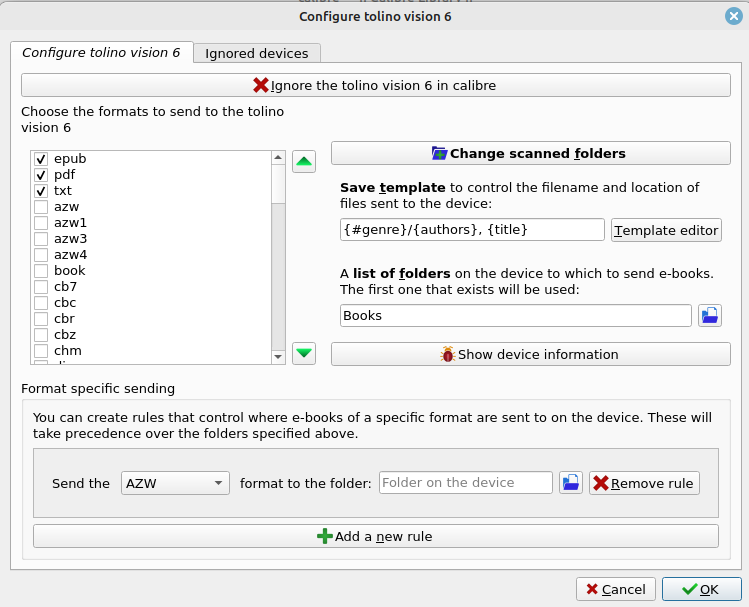

The paths in those error messages are a mess of unicode Left to right and right to left marks. Why is that? What are the device configuration settings in calibre? Right click the device icon to see the configuration.
Sorry for the delay! Is this what you mean:
For 'Show Device Information' I get this:

Name:	Screenshot from 2022-09-07 17-51-47.png
