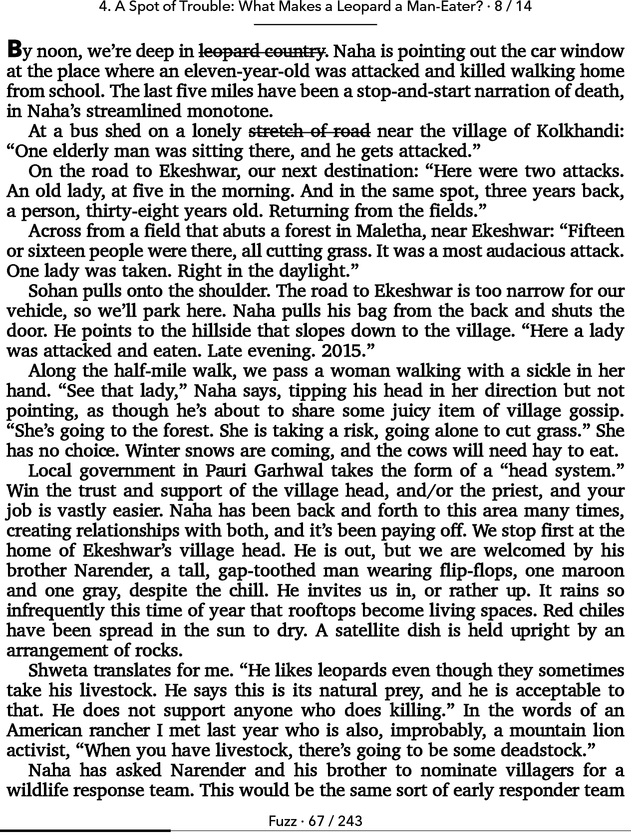

I'll have to look into that font. Here's a screenshot of what's happening on my Forma (Under King, duck knife is via <del>, behind beside in front is with my span and beak is with <s>:

I checked the same book on my wife's Forma and it looks the same as on mine. So, it doesn't seem to be a problem with my specific unit.
BTW: the strikethroughs look much more visible in that screenshot than they do on the actual device.
