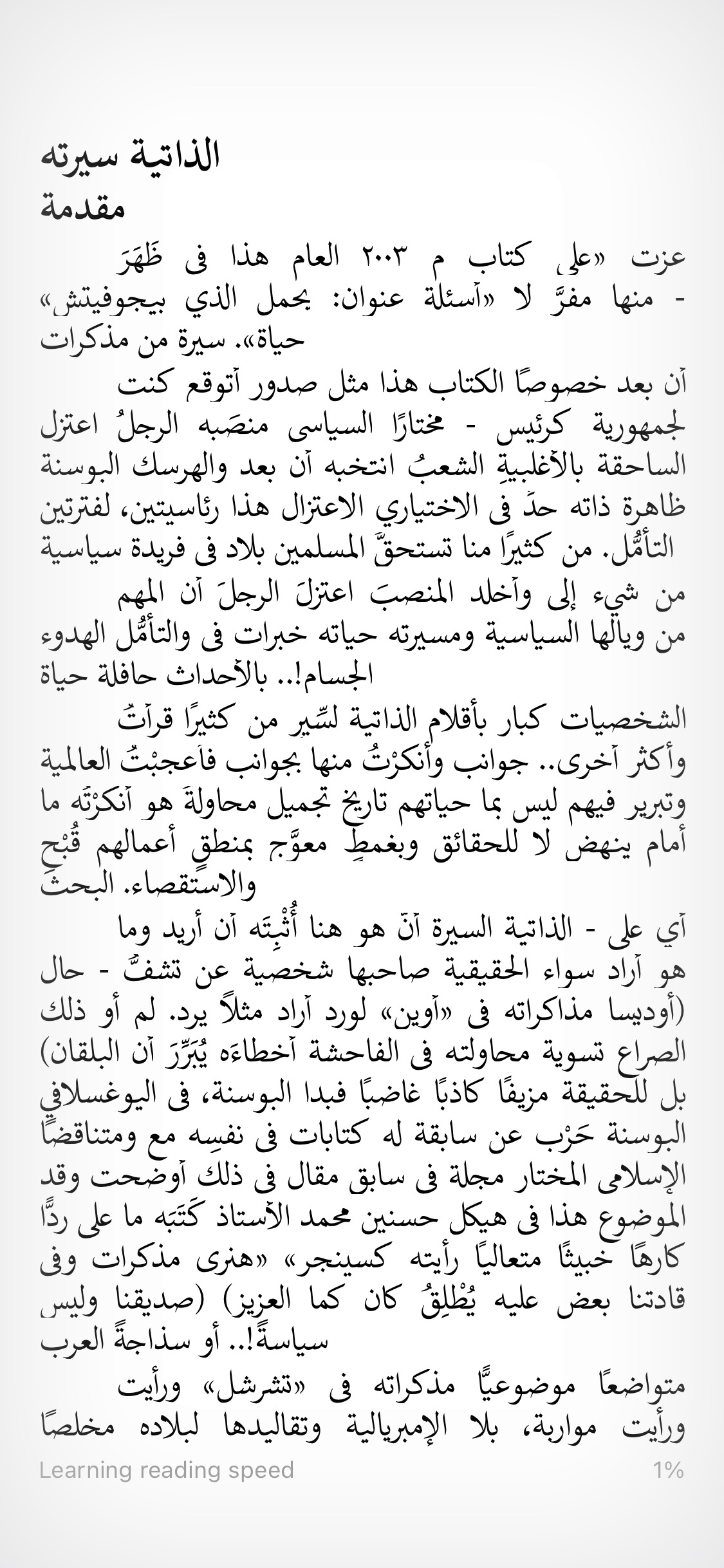

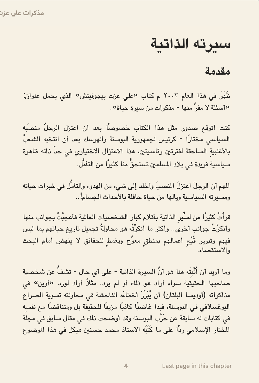

I have an EPUB in Arabic. It is right to left. It shows fine on Apple Books. However, when sent to kindle paper white, paragraphs directions changes.
Kindle: Headers stays rtl but paragraphs are ltr.
iPhone Kindle app: alignment is rtl but the words are ltr. i.e. I must read from left to right to make sense of the sentences even though lines are aligned to the right.
I know the underlying technique for sending ePub to kindle is converting to AZW3. Is this a problem with AZW3?

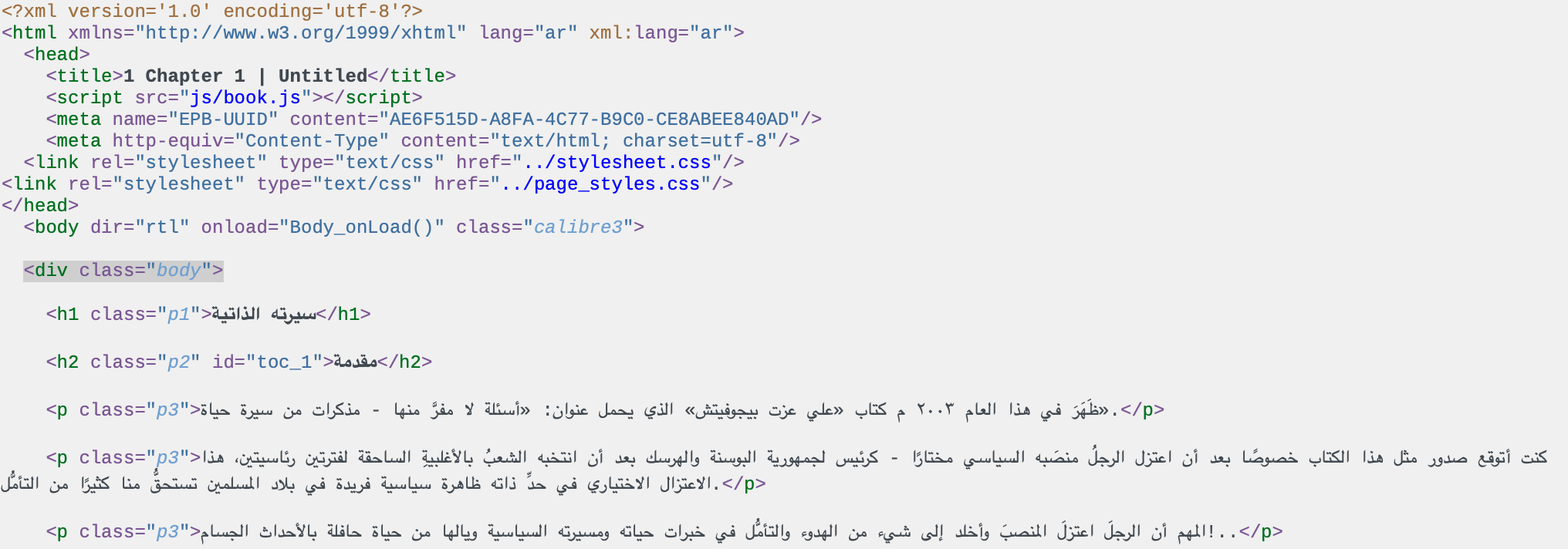

I do not have any CSS files.

What do you mean by adding text direction? It's already added in the <body> tag. Is there another place to add it?

I don't know if that's correct for KF8 and it depends what Amazon's conversion did to the code. The only way to know what may be going on is to look at the code for the converted KF8.
