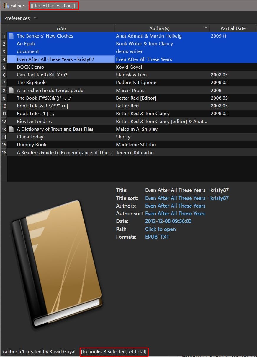

What we need to know is what's in the red-boxes :
Name:	Screenshot 2022-07-18 095928.jpg
The Title Bar tells me I am looking the physical library Test virtual library Has Location. The Status Bar tells me the Has Location virtual library has 16 books, of which 4 are selected, and that the Test physical library has 74 books.

Library is not on a network, it's on my C drive in the Calibre folder in Documents, the parts you marked in red read, Calibre/Calibre and 703 books.
I've tried to add a screenshot, I hope that helps, thanks

OK that verifies a) there are no virtual libraries in play, and b) that the data base does indeed only have 703 book records.

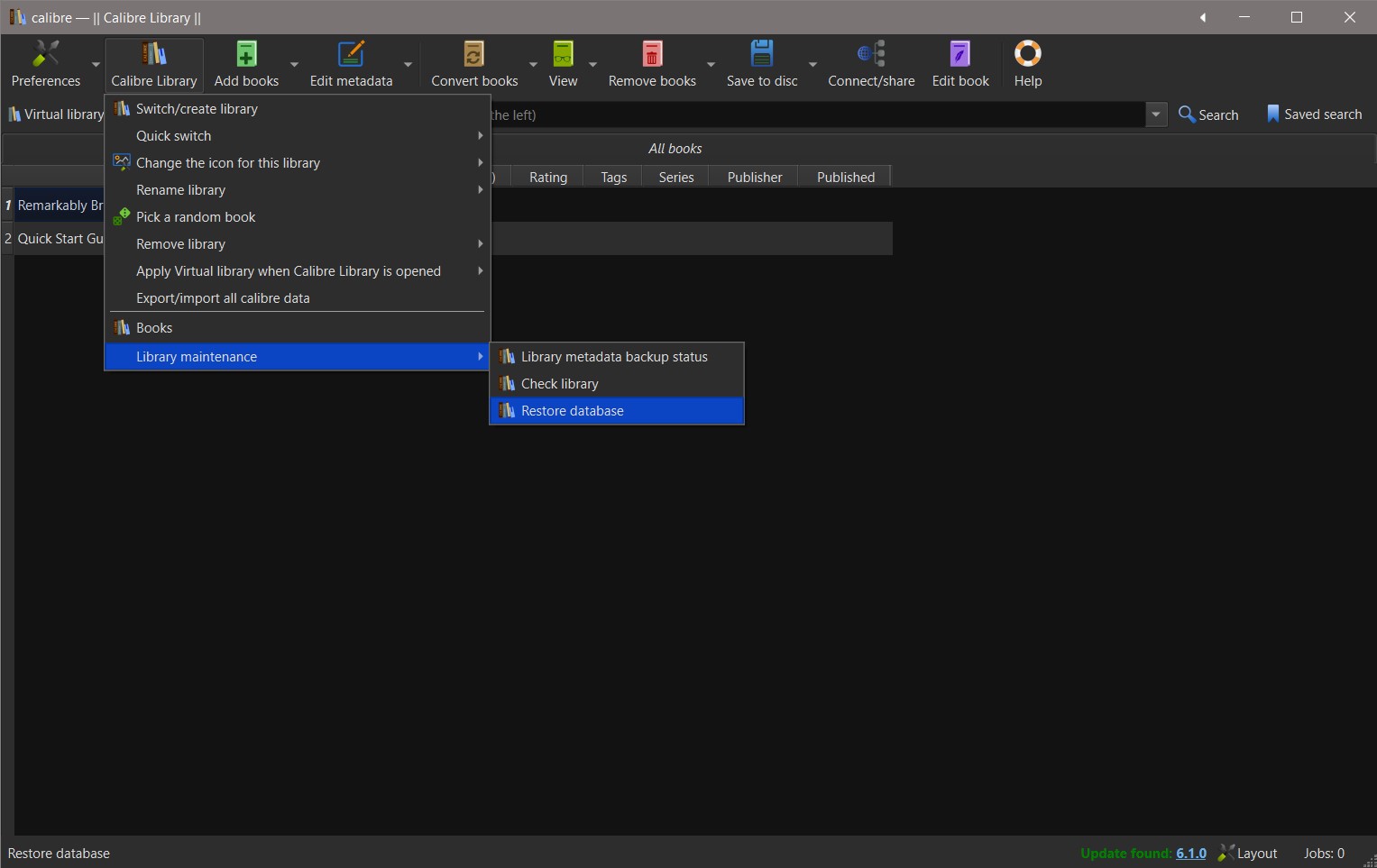

Assuming the metadata.opf files are present, and after ensuring I had a backup copy of the library I would use the Library Maintenance->Restore database option, viz:
Name:	Screenshot 2022-07-18 180025.jpg
That will reconstruct the database… the metadata.db file in the library folder… from the metadata.opf files… that's why they exist. It will take a while for 7,000 books - watch a movie or have a snooze.
Attachment 195104

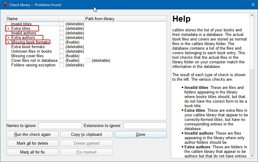

I suggest that the OP run both parts of Library Maintenance->Check Library. If the books are in the library folder with syntactically correct names then part 2 of Check Library will show them in various ways (see screen capture). If it does not then Restore Database won't do anything useful.
Don't actually "fix" anything using "Check library". That will result in data loss.
EDIT: The screen capture notwithstanding, any of the lines in Check library can have content (the sideways triangle). The library is OK only if no line has the triangle.

I was planning to get the OP to run the Check after the Restore; there may be some books that are recoverable and others that are not recoverable.
I suggested running it first because a) it is quick which restore is not, and b) if it doesn't find errors then restore won't do anything useful. If it does find errors then they can be instructive. For example, "Extra" authors are folders that don't contain syntactically valid book folders, which probably indicates external tampering of the library. There is something similar for title folders, checking the syntax of the folder name.
