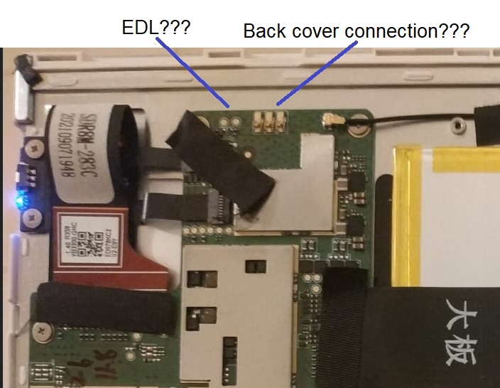

Edit - disassembled, any idea which are the edl test points?

Old 07-08-2022, 07:43 PM   #8
Renate
Onyx-maniac
Posts: 4,577
Karma: 22201479
Originally Posted by nivieru View Post
Well, I tried that.
Now I just get a white screen, no ADB or anything.
And you had ADB working fine before with drivers and everything?
When you disconnect the USB cable and then reconnect does Windows go "bong"?
When you want to get out of trying recovery you can fastboot erase misc.
Do you have: A voltmeter? Any resistors 100 to 3000 ohms? A USB UART adapter?
I'm sorry to say that nothing looks that conspicuous on the board.
Is there something on the back cover that receives those 3 springs?
If there is nothing on the back cover it could be UART test points, but that seems unusual.
You might try a photo of just the board on the left. Maybe two separate photos.
I wouldn't go around indiscriminately shorting any points, you could do damage.
OTOH, if you have a voltmeter you can measure the voltage on the points in the photo versus ground (like the tin shields).
Edit: I'm thinking those springs are to another antenna on the back cover.

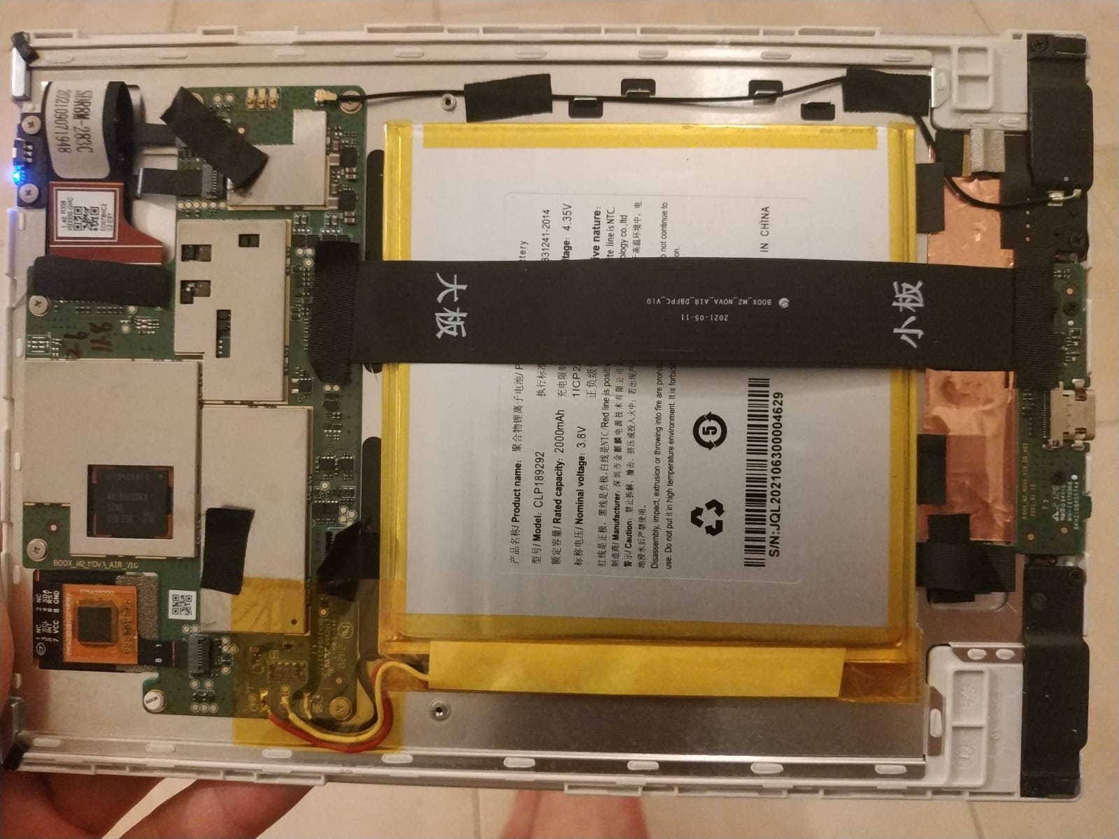

Edit - added photo

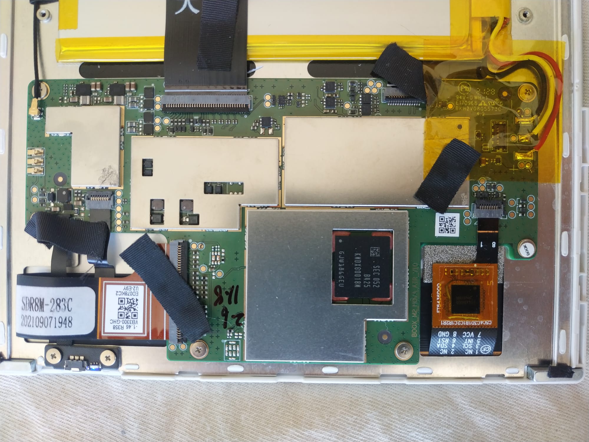

Can you still get to fastboot? If you can, "fastboot erase misc".
Can you measure voltages on the two "maybe?" points.
Maybe one is 1.8V and the other is smallish 0.2V but not 0.000?
Are the "tin cans" one part, soldered to the board or are they a soldered-in base and a top that snaps on with little "dimples".
Do you have resistors?

The "maybe" points are both at 1.8V, with about 30mV between them
The tin cans are not soldered, look removable.
I don't have resistors, and can't get into fastboot either.
Edit - added photo with tin cans removed

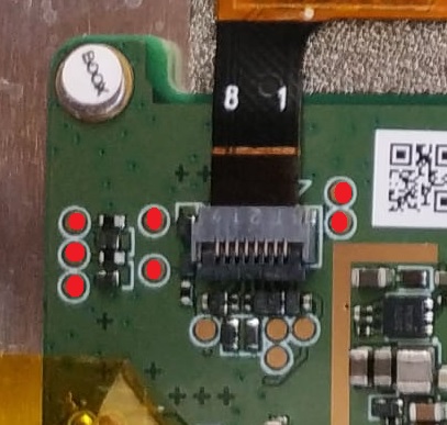

Grrr, can't get into Fastboot isn't good.
Check the two pairs of red dots for same 1.8/0.2 criteria.
Look at the triple red dot for 1.8V/???/0.000.
Oops, I forgot, my Poke3 (SDM636) has 1.8V UART (for the triple)

Theses are the measured voltages, no 0.2V,
The one labeled in red is a little higher than the others, by about 20-30mV
