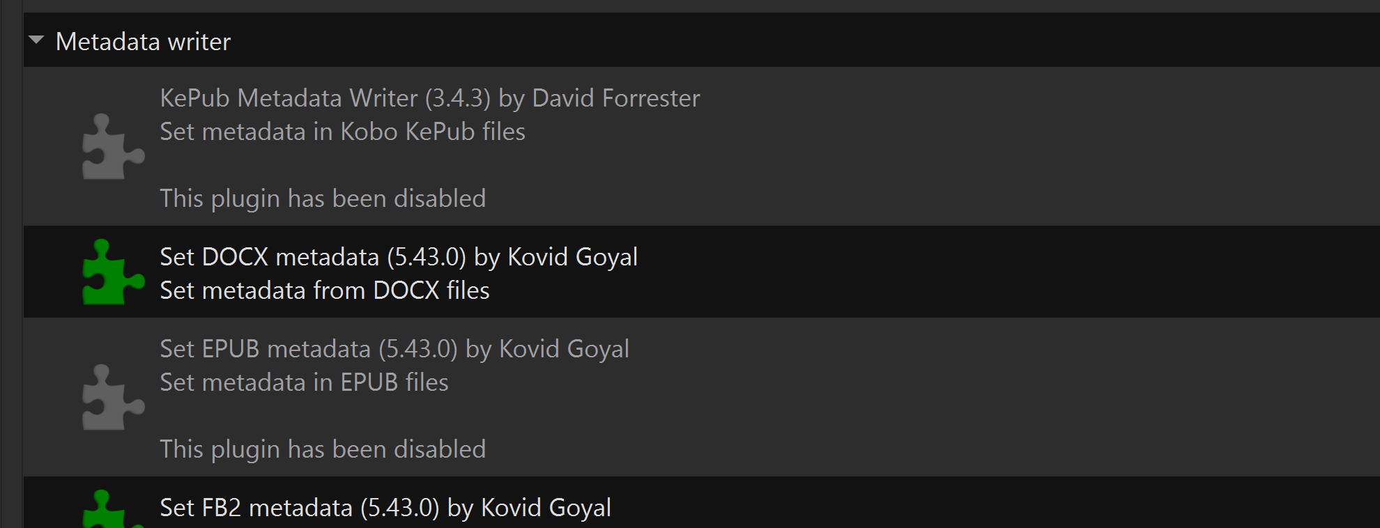

Turn off updating metadata in epub files if you dont want metadata written to them. Preferences->plugins->disable the epub metadata writer plugin. And turn off saving bookmarks inside epub file in the viewer preferences.

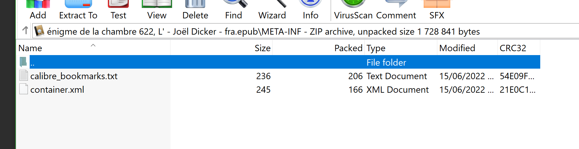

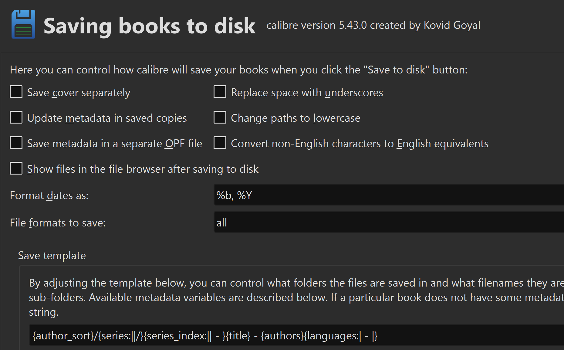

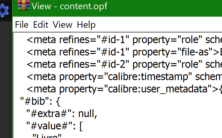

I think I did as you said but I’m still getting the data when writing to disk. What did I missed?

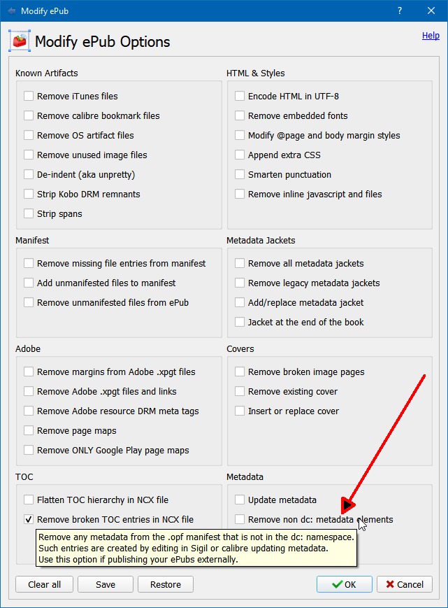

The Modify Epub plugin can remove all non-dc (non-standard) metadata from the opf in an epub.

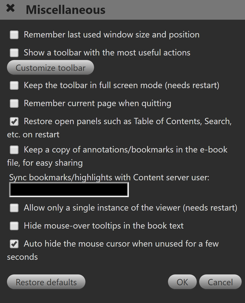

You turn this off in Preferences > Saving books to disk.
For the editor you do this in Edit > Preferences > Integr... with calibre.
For the viewer you do this in Preferences > Miscellaneous.

If you've disabled them there is no way they are being added. Start with a fresh epub and test.

Thanks, now I have understood the problem and how to fix it.
Calibre keeps the metadata outside of the books.
I nearly always edit the book epub to clean it. The editor was saving the calibre metadata into the epub.
When viewing books, it was also adding the bookmark to the epub.
These settings are now set as I wanted.
I just have to clean my existing epub using the Modify Epub plugin.
