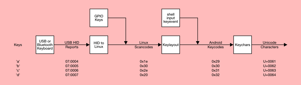

You got me scratching my head. Since Android is (basically) Linux you can do this the Linux way. That's the way I've always done it. Then I realized that there is the Android Setting with selecting keyboard layout. I can only presume that that's done after the Linux system has already mapped things around. Gee, that makes things complicated. The attached drawing shows how it works without the Android Settings. The Android Settings is yet another layer!
I tried the Android Settings under System/Languages/Physical Keyboard and it works.
In the Linux world we have key layout files (*.kl) and key chararacter maps (*.kcm). For Android we also have input device configuration files (*.idc). These are all found in /system/usr/keylayout, /system/usr/keychars and /system/usr/idc (respectivelly). To make your own files your device will need to be rooted or Magisk-ed.
Whether you are using a wired USB keyboard or a Bluetooth keyboard really doesn't make a difference. USB was/is the standard and Bluetooth pretends that it is (kind of) a USB keyboard. Both are identified by a vendor ID (VID) and a product ID (PID).
So here's my Vendor_05ac_Product_0220.idc file:
# Configuration for Russian Bluetooth keyboard 05ac/0220
device.internal = 0
keyboard.layout = Generic
keyboard.characterMap = Russian
Since the keyboard is basically a standard English keyboard with funny things written on the keytops, the layout that I need to use is the standard one. OTOH, A "J" key has to generate a Russian "O" character (not a simple 006f for an Latin O, but a 043e for a Russian O).
Here is a part of my Russian.kcm:
key J {
    label:                              'J'
    base:                               '\u043e'
    shift, capslock:                    '\u041e'
Ok, this all seems like a lot of work, but you can probably find a Persian .kcm file easily. It also has the advantage that you can further customize. Let's say you often intermix Persian and French. You can set Alt-C to give you a c with cedilla (the squiggly tail).
So, in short, to answer your actual question. You can definitely do this the Linux way (if you're rooted/Magisk-ed). If the Android Settings lets you set the keyboard to Japanese and Russian but not Persian then the Settings is not going to help you. It might just be a case of different Perisan keyboards.
I just learned that you can write an app for injecting your own key character maps. For the real dirt on that, see: https://developer.android.com/refere...YBOARD_LAYOUTS
Since I'm already rooted and customized I'll stick with my method.

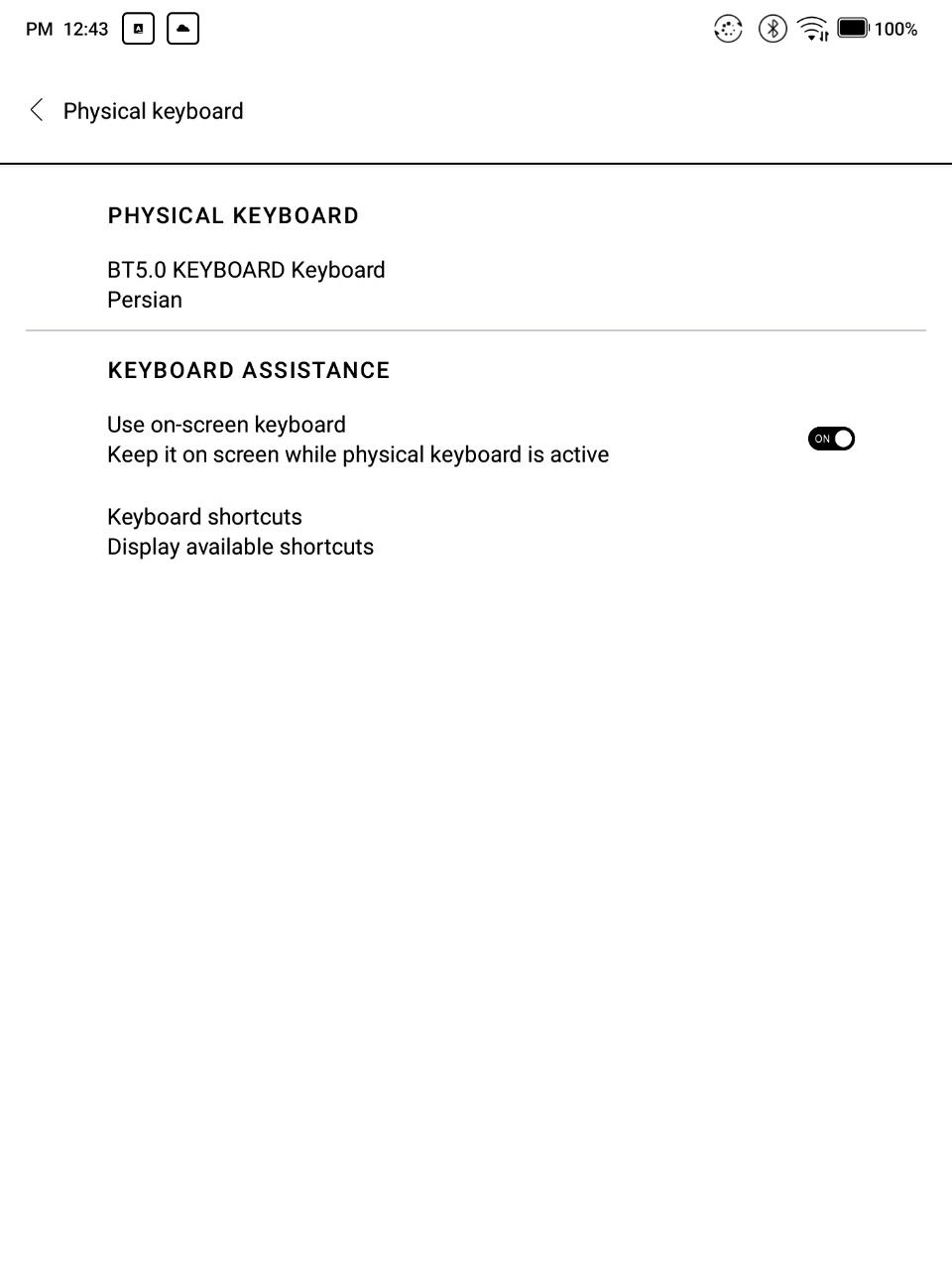

Thanks a lot for your time and your helpful information, dear Guru. Honestly, I'm not an expert and didn't understand some parts of your text.
I changed the keyboard layout to Persian, as you see in the attached screenshot. But still, when I type, It is English. As I told you, other languages (like Arabic and Hebrew) work correctly. I also tested my physical keyboard with other devices, and everything was fine with Persian language typing on those other devices.
Can I just paste a Persian .kcm file in /system/usr/keychars if I can find it? Will it solve the problem? Is it just doable if my device is rooted? Isn't there any way if it's not rooted?
Thanks again and sorry for the fundamental questions

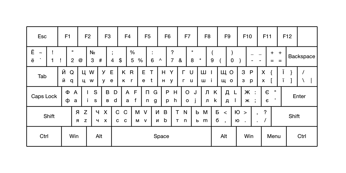

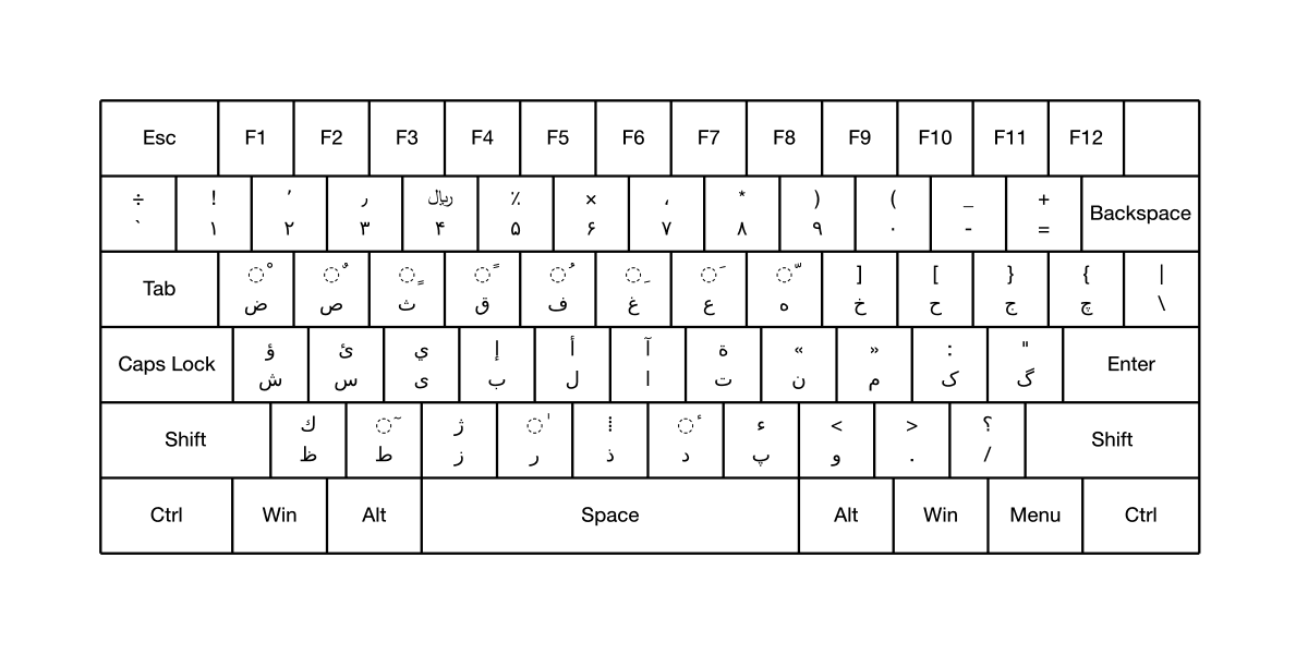

I wrote a utility for displaying keymaps. This is what you currently have.
Edit: The four dots above the 'B' key are to indicate the U+200C Zero Width Non-Joiner (which would be invisible).
Edit^2: If anybody would like a printout of a stock Onyx keyboard layout, just ask. Available:
arabic
azerbaijani
belgian
brazilian
bulgarian
croatian_and_slovenian
czech
danish
english_uk
english_us
english_us_colemak
english_us_dvorak
english_us_intl
english_us_workman
estonian
finnish
french
french_ca
german
greek
hebrew
hungarian
icelandic
italian
latvian_qwerty
lithuanian
norwegian
persian
polish
portuguese
russian
russian_mac
slovak
spanish
spanish_latin
swedish
swiss_french
swiss_german
turkish
ukrainian
ID:	194262   Click image for larger version

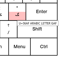

Hey! Here's some more fun: an interactive version of these layout diagrams.
It's in SVG format. It will work on Firefox, Chrome and Microsoft Edge, probably others.
Since the forums won't upload SVG, I've renamed them XML (which is actually what SVG files are).
My Firefox is smart enough to open them and realize that it's SVG.
If your browser can't, just rename them .svg
Just mouse over a letter and it will tell you what Unicode character it is.
Edit: Yet more progress. The official Unicode name for the character will appear when you hover. More fine-tuning.

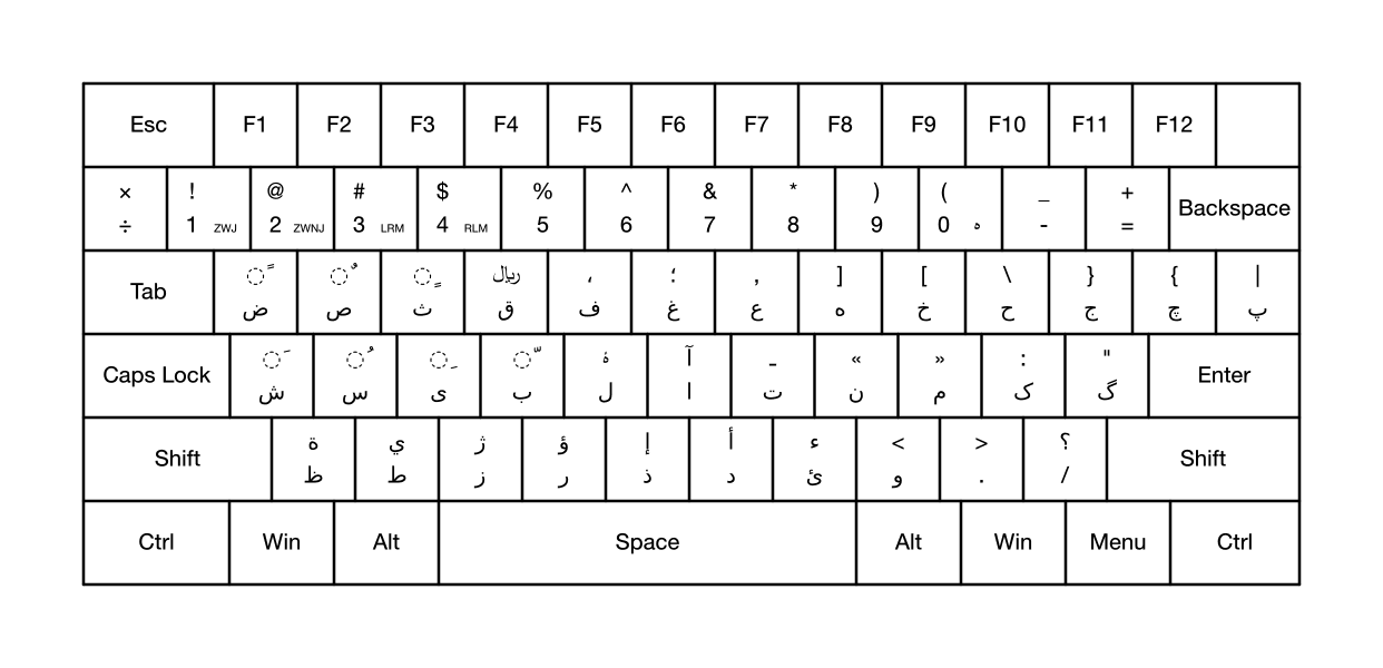

C:\>adb install KbdMaps-1.0.apk
There are two different key maps there, "Persian (MS)" and "Persian (Onyx)"
(Just rename the .prc file .apk, just rename the .xml file .svg)

Thanks a lot for your prompt and helpful reply. Everything is awesome. I just faced two issues, and I truly appreciate it if you help me with them too:
1. In Persian (Onyx) there is no Arabic Letter Gaf (U+06AF) on the ['/"] key.
2. In Persian (MS) I couldn't find the Zero Width Non-Joined (U+200C). In Persian (Onyx) it is on Alt [B] key, as you mentioned before. In Persian (MS) it could be on Alt [-/_] key (activated by pressing Shift and [-/_] key) and on Ctrl + Shift + [2/@] key.
Best
hamaviz is offline   Reply With Quote
Old 06-14-2022, 05:31 PM   #15
Renate
Onyx-maniac
Posts: 4,505
Karma: 22077803
Alt-2 is ZWNJ
