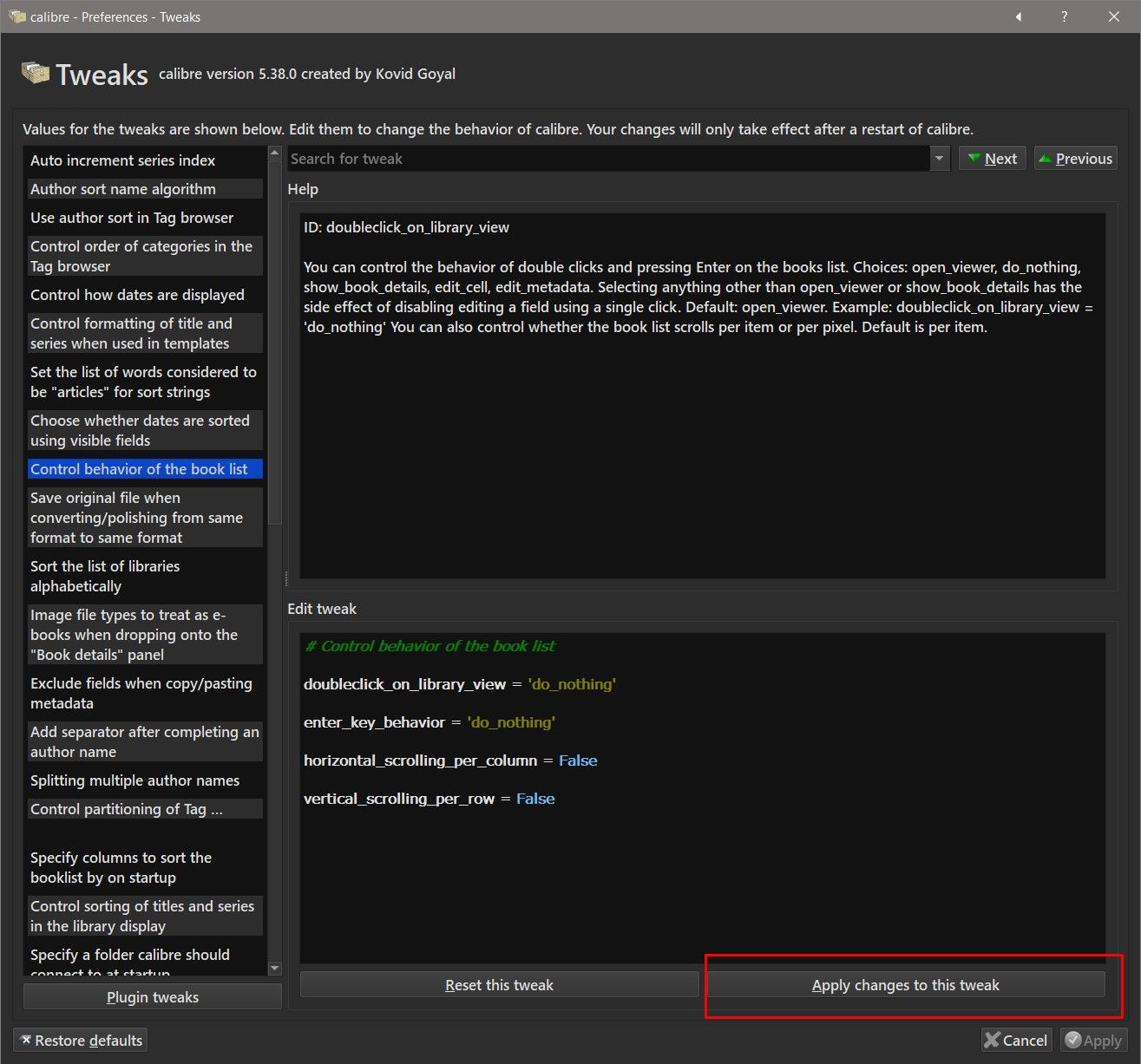

@arguendo - to activate the main Apply button you must hit the Apply changes to this tweak button for the individual settings you change.
Never change anything in the calibre installation folder (e.g. C:\Program Files\Calibre2),
If it is a permissions problem it will be in the Configuration folder, which I doubt, you can open via the Preferences>Miscellaneous->Open calibre configuration folder button. If you can open files there with a text editor then it ain't a permissions problem.
Name:	Screenshot 2022-03-16 085029.jpg

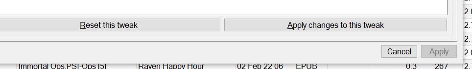

It is scrolled off INSIDE (user UI font too big?)
