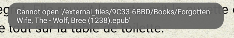

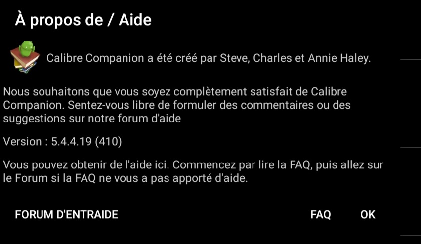

Hello, I have an issue too. I had to reinstall Calibre companion and now it's impossible for me to access to my library through calibre companion. Version installed 5.4.4.19 (410). I can only open those files with FBReader.
I'm sorry if someone has already asked this question but I can't the rght answer for me.
Thanks for your help.
