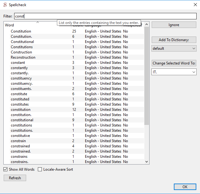

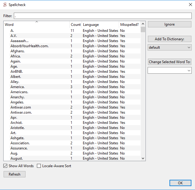

See some comparison images.
Before vs. After:
ID:	196177 Click image for larger version
ID:	196179 Click image for larger version
Much fewer words per screen, and near-words (or typos) get lost under all the "duplicate periods".
Plus, your eyes are always "stutter-stepping", because of the:
  • 1 character smaller
  • + 1 character bigger
    • Oh, great, another period...
When 99% of these extra "words" are duplicate periods... your brain turns off.
That's the major problems, as I see it, but I've got many other intermediate/smaller ones too.
Here's a few I picked out of the last book I worked on:
Problem #1: Indexes/PageNumbers (especially roman numerals)
Similar to Spellcheck Lists in Calibre getting flooded with numbers, this index/roman numeral issue also kicks it up to 1000!
You get hundreds and hundreds of extra:
i.
ii.
ix.
I.
II.
III.
clogging almost every single search—again, drowning out many of the otherwise at-a-glance issues.
Problem #2: URLs Lost
One trick I love/d to use is a period to find yet-to-be-linked URLs in a book:
ID:	196181 Click image for larger version
URLs are completely lost in Spellcheck Lists now.
Not just by (partial) acronyms but by every single sentence now too!
