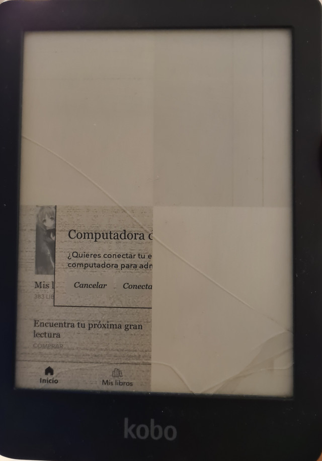

As the title says, I dropped my Kobo Clara and when I picked it up the screen was all white with a crack at the bottom corner. It now turns on but I want to make a calibre backup, but I'm unable to tap on the connect button (yes I know I should have reapplied the auto connect patch but oh well...)
So, the question is... Is there any way to connect the Clara? As of right now, it doesn't even seems to be detected by the computer, it doesn't make the sound when you connect an USB, nor is it listed on device manager

What trick are you using to do that? As far as Windows or any Linux box I have used is concerned, the computer sees the SD card as an SD card. Calibre won't do anything with it. It just sees a card and needs to be told what it is. And of course, Windows does not like removable media with multiple partitions, so it will complain.
@fedex-bermu: What you do depends on the state of the device. If it is starting, reaches the home screen and responding to input, you might be able to do things based on that. Your screenshot suggests that the screen is updating. And the bottom-left quarter suggests that it is recognising the computer. But, the cracks might mean the touch is not working. The "Connect" button is there, so if touch is working, it should connect to the PC.
If the touch is not working, you could try some of what @LinuxArie suggested. Take the card out and put it in the computer. Then you can backup what you can see. Or you could edit the config file and add the auto connect USB line and put the card back in the device. After that, it might connect when you plug the device in.

Posts: 85,559
Karma: 154365185
Attachment 192206
Your Clara HD has a broken screen. The problem you may be having is that you may not be able to press connect when you plug the Kobo into the computer. The only way to get everything off is to do as was said in the second post.

Next, plugin the SD into my laptop saw it like an SD, with multiple partitions. Although on one of those partitions were all my books, I wanted calibre to make a database backup, update my reading positions, etc. Which was not possible because it was not recognized as the Kobo Clara.
Next, I tried to add the autoplug option in the Kobo conf but still it refused to auto connect, so as my last option I tried to run the Kobo patch and move the Kobo root.tgz with the autoplug enabled, and after a reboot of my broken Kobo I was able to connect and be detected by calibre. I know is such a niche problem, but maybe someone in the future has a similar problem and wants calibre to backup his progress, so this is the only way I could solve it.
