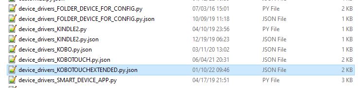

Old 01-12-2022, 07:09 PM   #6
Posts: 32,018
Karma: 65700000
David
Once a device is connected/used the configuration is saved in the configuration folder.
Preferences version is only used for New(first connected) devices
