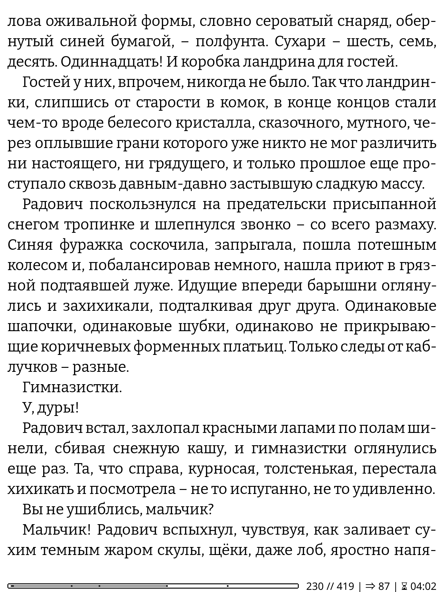

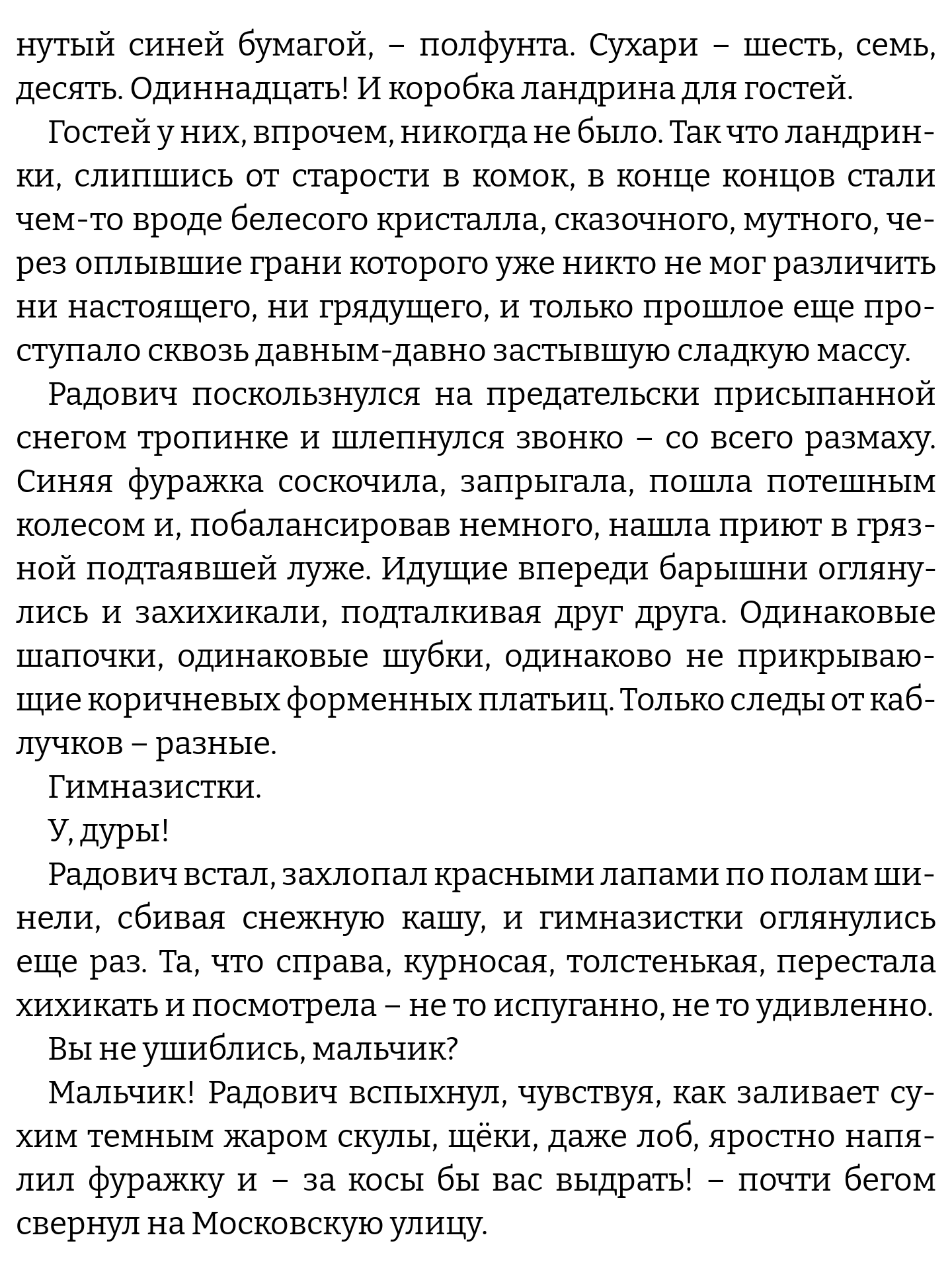

With the "Reclaim" option On and status bar hidden it does appear symmetrical. With the "Reclaim" Off and status bar shown it is not, and that was what I was confused about. I guess it was just me to expect the symmetry in the remaining text box above the status bar

That's indeed what I would expect .
(Besides me not actually using the status bar all that much, I also find the default status bar effect on all this confusing, which is kind of why I added the Reclaim option ).
