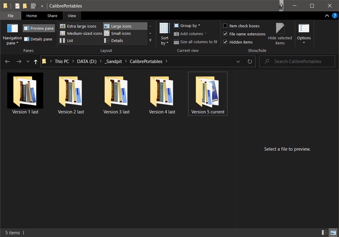

Originally Posted by JollyRoger View Post
The folder that holds all my portable stuff is excluded from any scan or anti virus, and there's been no message to say anything was bad. My system hasn't changed in years, but if noone else has stated a problem then it must be my computer.
However this is the first time I have noticed that if I install it to a new folder, and call the new folder "Calibre test", when it unpacks all the files are contained inside a subfolder called "Calibre Portable". That's never happened before. Why would that happen?
The initial install of Calibre Portable has created a folder of that name for years, maybe forever. It can be changed, but best done immediately after installing. Subsequent installs can overwrite an existing install irrespective of the folder name.
All of these folders started life as Calibre Portable:
Name:	Screenshot 2021-11-23 084509.jpg
I just upgraded the Version 5 current folder from 5.16.1 to 5.32.0.
BetterRed is offline
