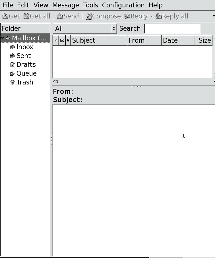

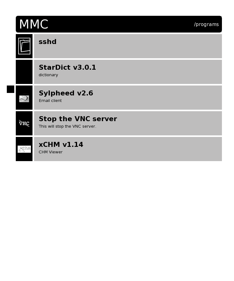

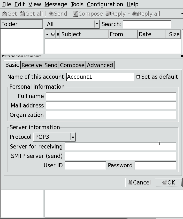

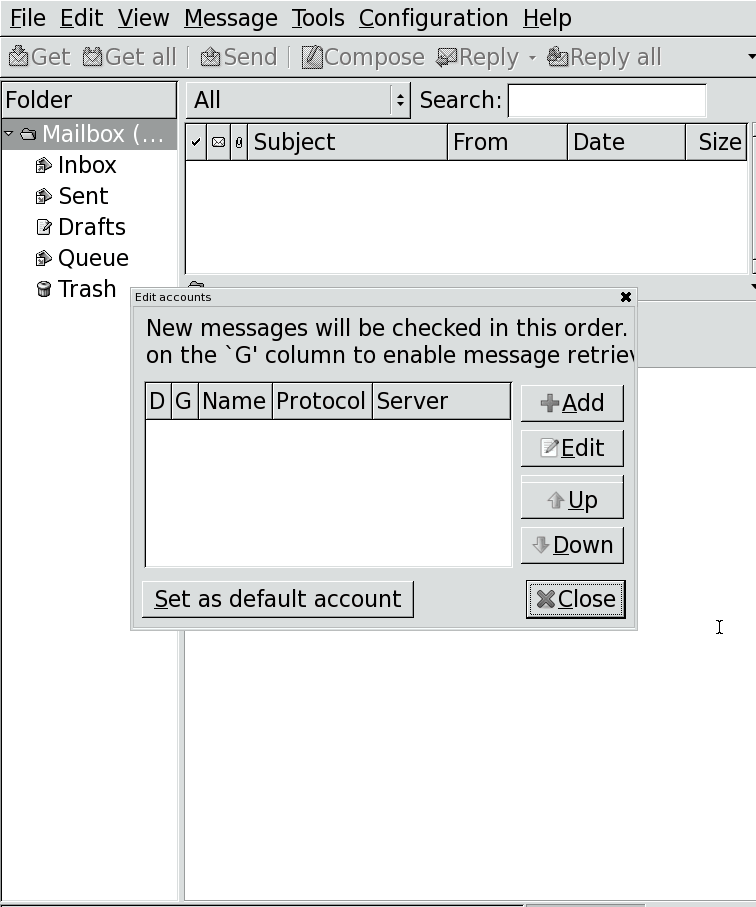

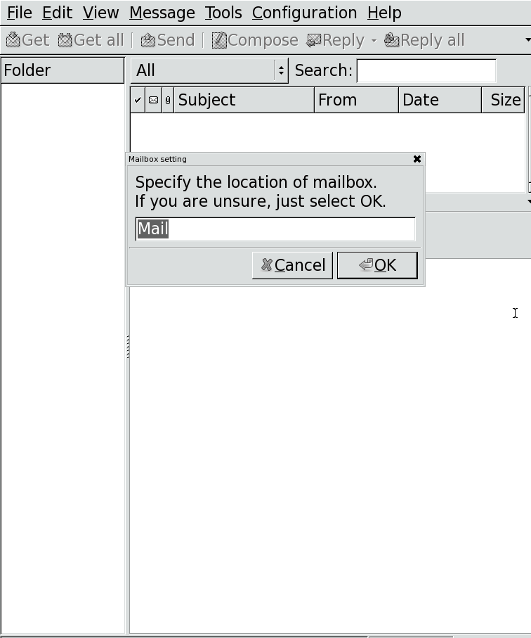

Sylpheed is a email client supporting several languages.
I only tested its GUI is working. The operation is quite smooth. I havn't actually setup a mailbox and receive email. Try it yourself.
How to install:
1. unpack the attachment to "programs" dir in your SD/MMC. A dir "sylpheed" will emerge.
2. grab required lib from other software that I released.
3. put xepdmgr contributed by Antartica in the same dir
4. run from contentlister

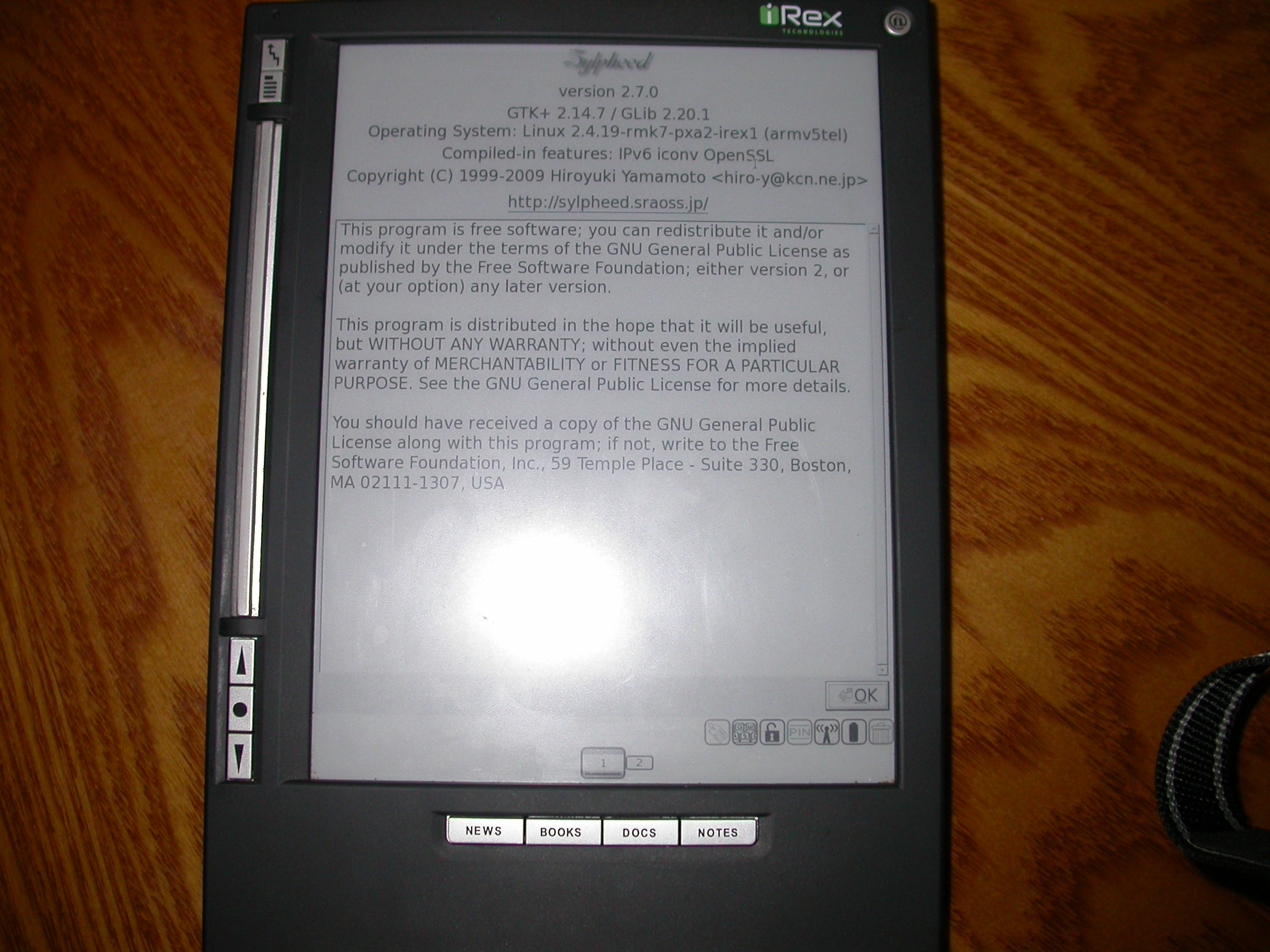

This is Sylpheed 2.7 for iLiad. To install, just unpack the attached package to dir "/MMC/programs" and a dir "sylpheed" will emerge. To execute, navigate your contentlister to dir "/MMC/programs" and click on the Sylpheed icon.
Antartica's Xepdmgr is included in the package. Thanx for his wonderful work.
I built this package with GTK+2.14 and I am using it on my iLiad. Since iLiad's official GTK+ is 2.6, I don't know if it will work on others' iLiad. Normally, Sylpheed should work with GTK+2.6.
If this package does not work on your iLiad, try execute ./run.sh in mrxvt and maybe the error message can help you figure out what's missing.
