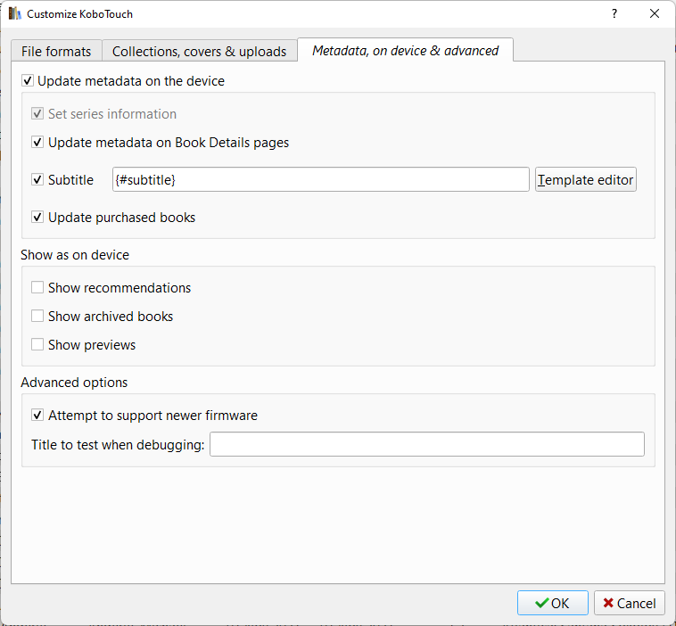

I had to factory reset my Clara HD due to a database issue and now after updating I have the same unsupported message. However I can still transfer books over OK through calibre, but I can no longer manage collections or remove books on the device via Calibre

Until the next update to calibre is released, follow the instructions in the error message and enable Attempt to support newer firmware. This is found on the Metadata on device & advanced tab for both the KoboTouch and KoboTouchExtended driver so enable it on the one you use or both since that does no harm. See attached image.
