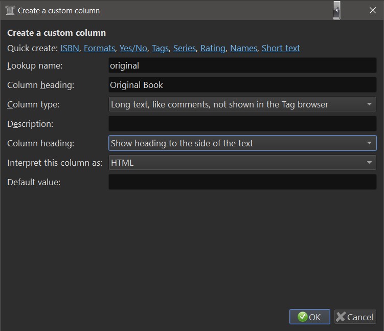

Create 2 libraries, Annotated and Originals
In the Annotated library add a column called original/Original Book.

In the Original library add a column called annotated/Annotated Book.

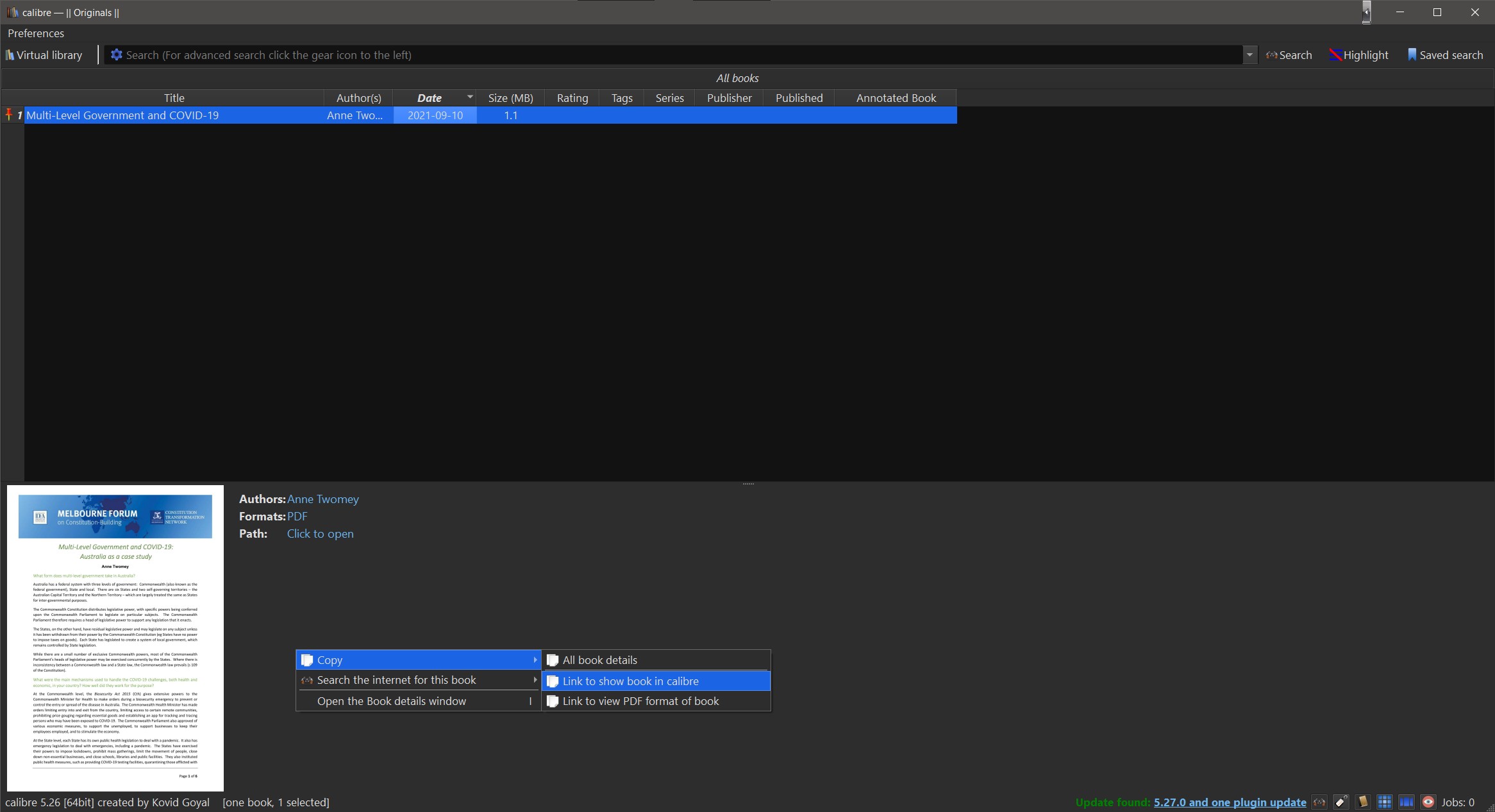

Add a book to Originals and copy its show Book link to clipboard

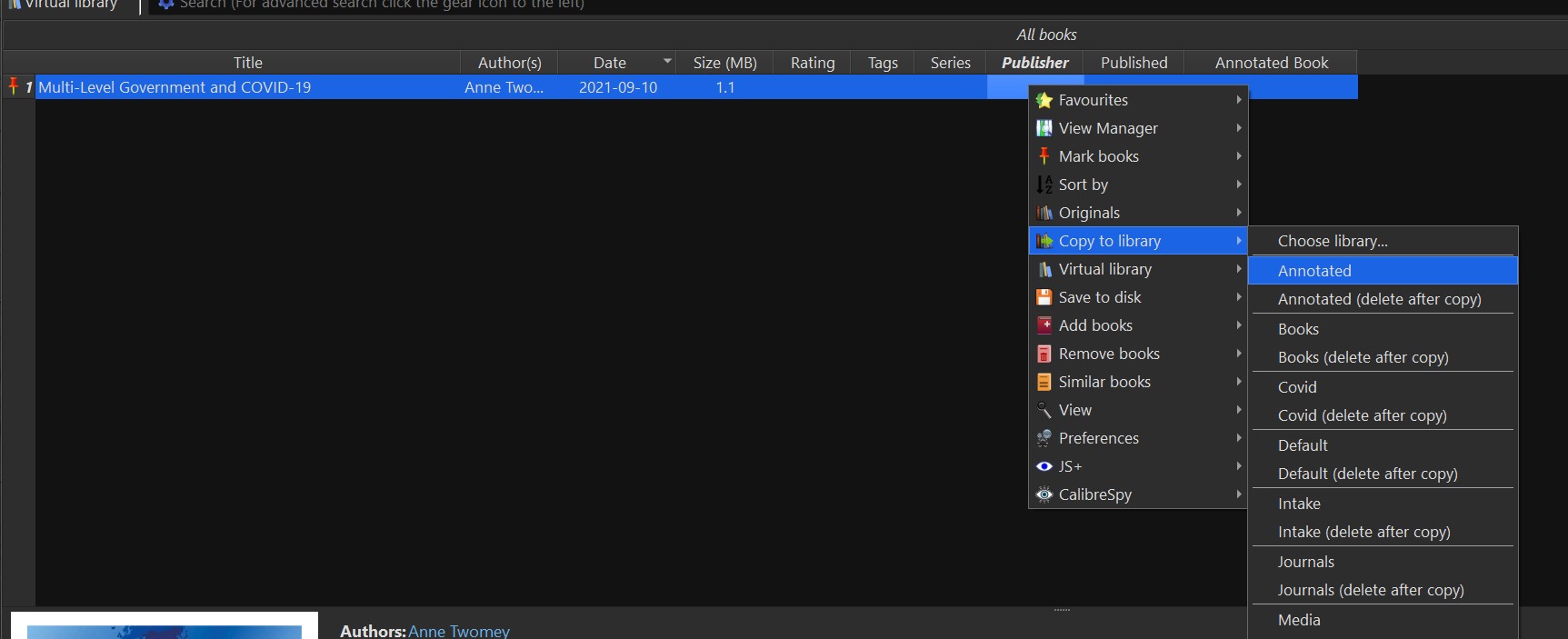

Copy the book to the Annotated library

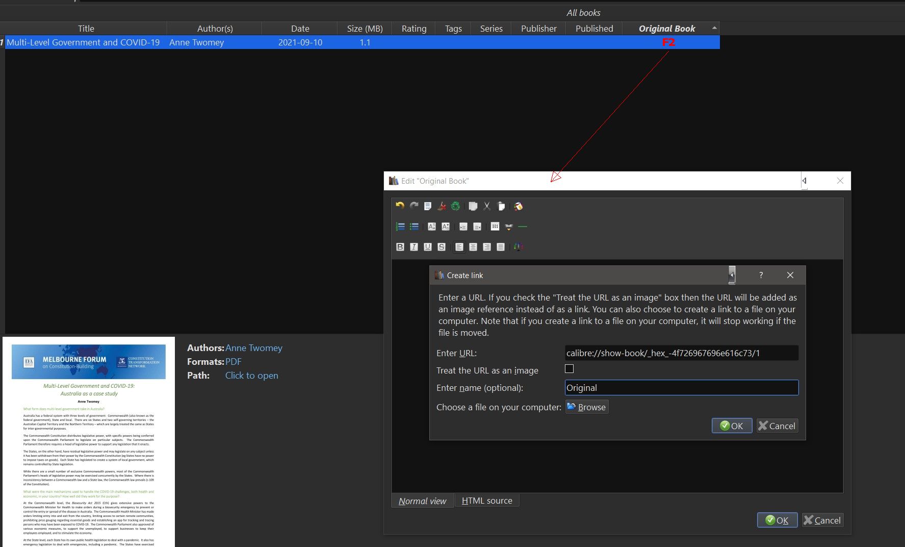

Go to Annotated library and put the link in the Original Column
Name:	link to original.jpg
