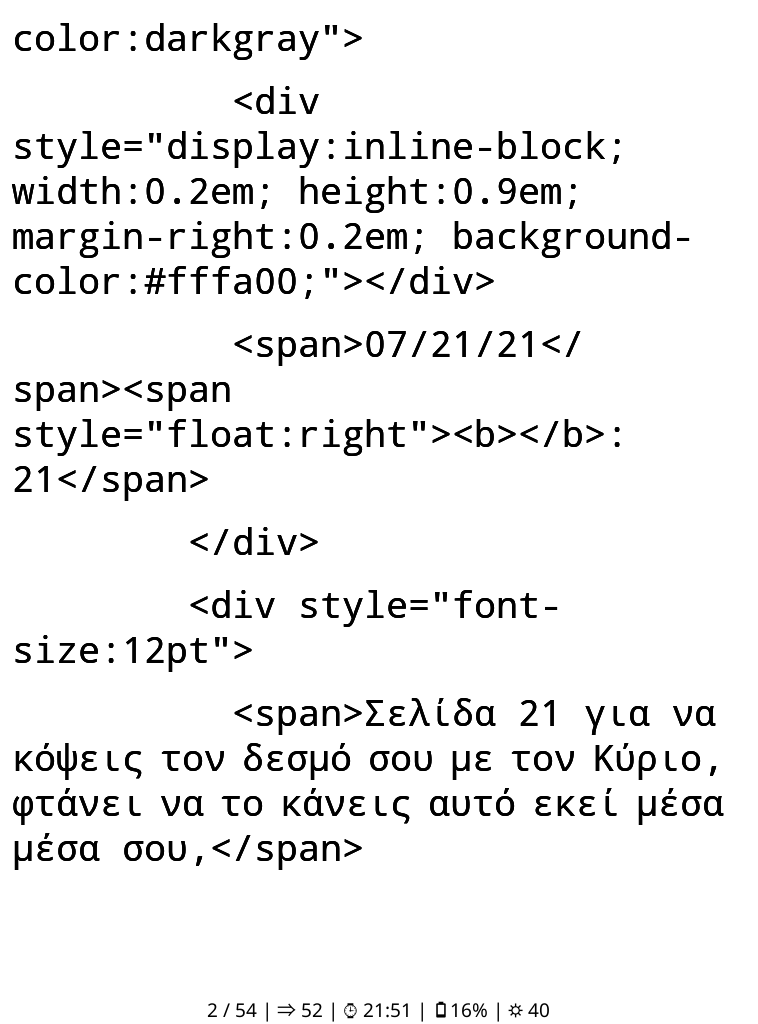

Hi,
I can't understand what's going on with Evernote...
While the older html files with extracted highlights are rendered correctly in KOReader, when I open the new ones, I see the page code (as below) and not only the title and the highlighted texts.
However, I can see those new html files being rendered correctly on the computer.
Am I missing something?

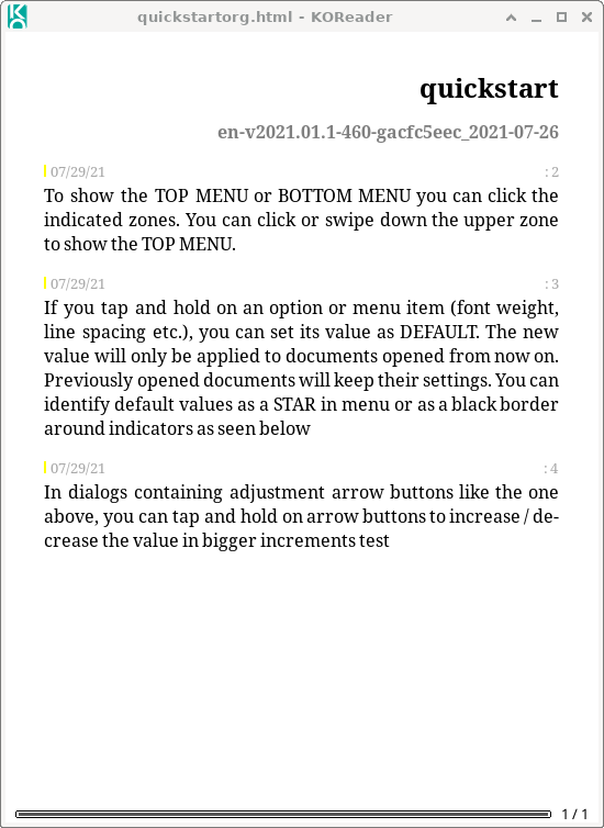

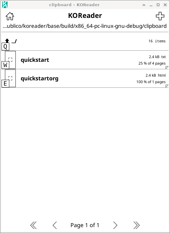

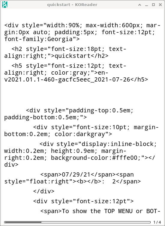

Probably. Html files are rendered correctly in both Coolreader and MuPDF engines (as correct as we can get).
Did you rename the files in clipboard?. There's no fancy file type recognition here. The app opens a file based on its extension. So if you rename "yourBook.html" to "yourBook.txt" the engine will open the plain text that's inside the document.
See attachments.

No, I didn't rename it.
The same file (with .html extension) is rendered in KOReader like your 2nd attached image and in the computer browser like your 3rd attached image.

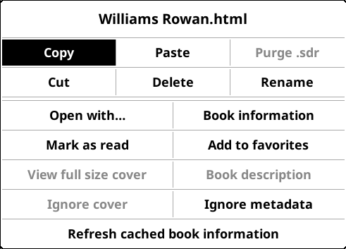

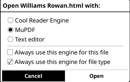

Originally Posted by ichnilatis View Post
This is an example with random highlights, with which the same problem occurs. (remove the .zip extension)
I can reproduce the issue with that file and CRengine. Cannot reproduce with any of my highlights/annotations but I don't read greek
Could you open a ticket?
In the mean time you can setup KOReader to open html files with MuPDF, which is unaffected by this issue.
Long press any html document and setup as attachments (clicking "open with")
Yes, I've already tried it.
