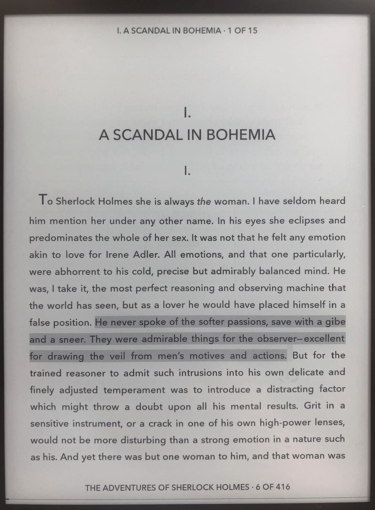

Hey everyone,
tl;dr I've written a script to import highlights from a kobo book to calibre app viewer; please go ahead and try it!
My reading workflow is very much about the highlights, so I like to have them backed up, and easy to come back to in the future. The key point is to be able to see not only the highlight but also the concrete page in the book as if it's a note in a paper book. I use Calibre to manage my ebook library, and would love to keep using it for my highlights collection as well.
I've recently got a Kobo Forma reader (which I love!) and was happy to find out that all highlights are stored in the SQLite database, with some precise location that looks like that:
span#kobo\.46\.1

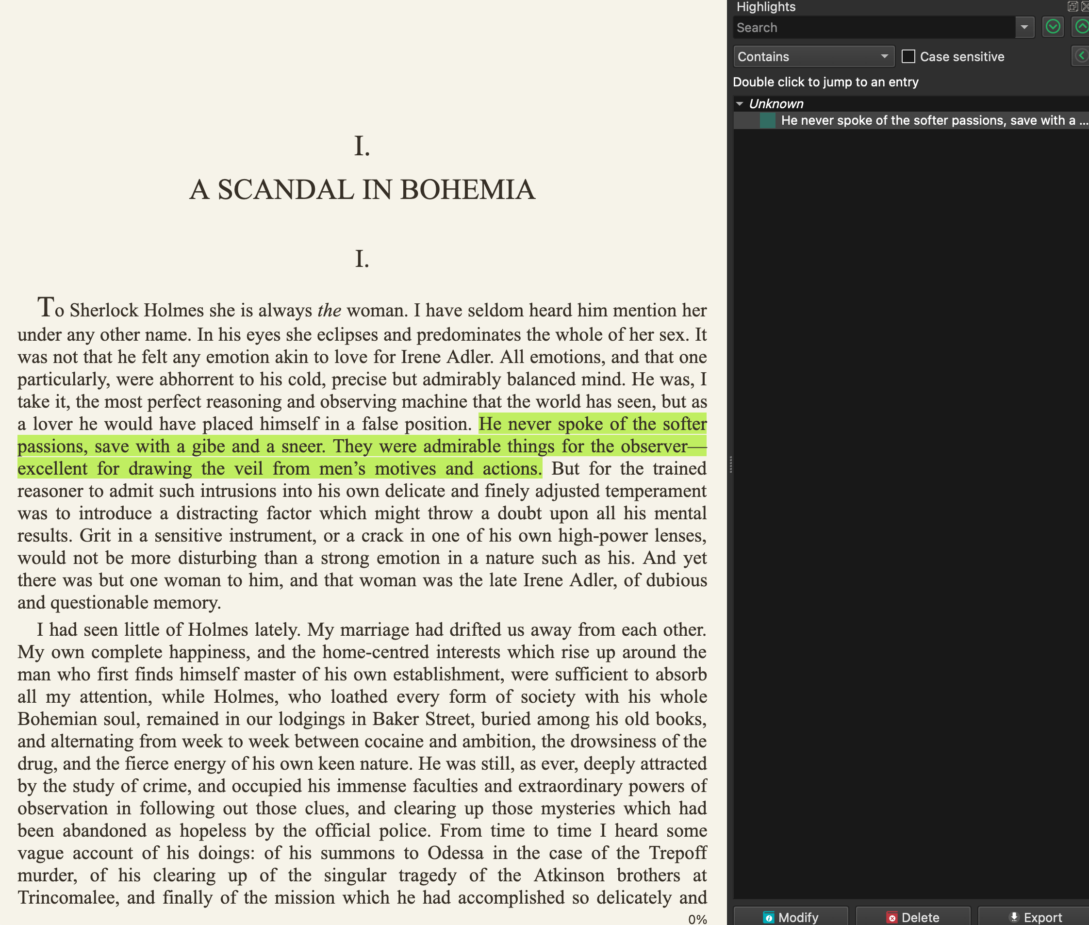

I've figured out that this location system is very similar to the EPUB CFI, the one that calibre is using for its ebook viewer highlight, and wrote a python script that imports the highlights from Kobo database, and inserts them into a calibre database as if you annotated text in the Calibre (see the screenshots).
You can find the script here.
So in a nutshell the script does the following:
  • reads all highlights from Kobo DB
  • matches the Kobo-book to the Calibre-book
  • converts location from Kobo-CFI to Epub-CFI
  • inserts highlights to the calibre DB, making sure there're no duplicates
ID:	188168   Click image for larger version
